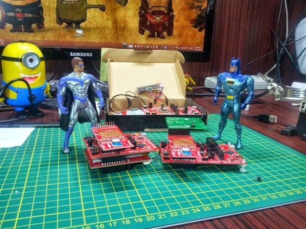

The Air Booster Pack
As always I won't try to replicate existing content and there are plenty of good reviews on the CC110Ls as well as the Anaren Air BoosterPacks. The microcontroller talks to the CC110L via SPI and there are two configurable IOs on the Chip as well. One should be used to generate an Interrupt on successful transmission or reception. The datasheet talks of the GPIO being used for serial data input but I really do not want to get into that unless absolutely necessary. Simplify things and get the job done I say. Below is the image of the Air Booster on the MSP430fr5969 LP and one on the MSP430F5529 LP.
I am still experimenting with some permutations and combinations on a better way to prototype things but right now, for this exercise I will be using these two standard Launchpads. The FR5969 is a low power LP and the 5529 is a USB LP and will be used for this exercise. The Kit contains two MSP430s preprogrammed with demo code and the Booster pack has the basic circuit layout on it. You can mount a few components and it will function without the need to purchase a LP. Cool concept and I am temped to try it myself however if I want to have sensors then I have to add connections or make a separate board anyway so this arrangement is good for demo purposes and I would rather make my own addon board... and I will... eventually.
Right now I want to get up and running as soon as possible so its use it as is for now.

The first step is to put the Air Booster Packs together with a Launchpad. As stated before, I have the MSP430FR5969 and the other is the MSP430F5529 each with an Air Booster. The FR5969 is programmed to be the sensor node which can measure temperature and values from a dust sensor. These are transmitted to the 5529 LP which acts like a hub and sends the data via serial connectivity to the console. The image below show my setup.
