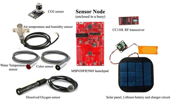

WIRELESS SENSOR NODE:
A. Microcontroller:
    16 bit MSP430FR5969 is the main microcontroller for the wireless sensor node. This MCU has two UARTs: one can be used for the transceiver and the other for sensors. Since I will be attaching multiple sensors to  a single UART, I will be using a 74HC4052 Mux/Demux IC capable of connecting up to four asynchronous serial UART devices into one single microcontrollers UART RX/TX pins.
B. RF communication:
    Data acquired by the node through its sensors will be sent to the base station through RF transceiver and I will be using TI's CC110L transceiver. Ideally, transceivers with longer range and capable  of mesh topology  should be  used considering node will be placed far from base station and my ultimate goal is to build and deploy network of wireless sensor nodes ( if I have enough fund or if our local government will give image). So for a single node project, CC110L will do with limited budget.
C. Power source:
    3.7V lithium ion battery with charging circuit and solar panel.
D. Sensors:
    1. Carbon dioxide sensor
              - with analog interface and using MG811
    2. Temperature and Humidity sensor
              -measure air temperature and humidity using SHT10 sensor
        • Humidity Ranger:0-100%RH
        • Temperature ranger: -10-80℃
        • Humidity accuracy:±5.0%RH
        • Temperature accuracy:±0.5℃
    3. Submersible temperature sensor
              -  digital output temperature probe with UART interface
              -  accuracy +/- 1C operating at 3.1-5V
    4. Color sensor
              - color probe can be used to monitor slowly changing events like algal bloom
              - outputs 8-bit format R,G,B data
              - outputs light intensity in lux
              - operating at 3.1-5V
              - UART interface
    5. Dissolved Oxygen sensor
              - during algal bloom, D.O. level drops and this will be a good indicator
              - output range of probe is 0-20 mg/L
              - interface either UART or I2C
So, that's it for now. image

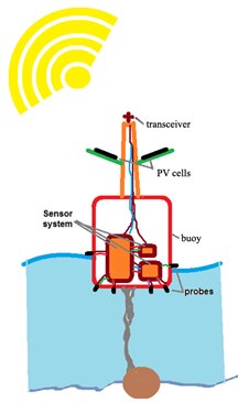

    DAB over 12 years ago +1
    Good post. I am really looking forward to how you put all of the sensors together. DAB
    mcb1 over 12 years ago +1
    I agree. Trying to keep the pesky water out while allowing the sensors to be immersed will be the hardest/clever bit. You may want to experiment with anchoring your flotation device BEFORE adding any electronics…
  • rmlab
    rmlab over 12 years ago in reply to mcb1
    Actually I'm contemplating what could be the best design for the buoy and other way to harvest energy than photovoltaic.
    Thanks for the input
    I agree.
    You may want to experiment with anchoring your flotation device BEFORE adding any electronics, since the wear of the attachments points will be high as it bobs up and down.
    I wonder if a 3-4m pipe-like device that is half submerged and absorbs waves will ride better over a longer time, rather than something that floats on the surface, and is constantly fighting it's anchor.
    You may even be able to incorporate an energy generator inside.
