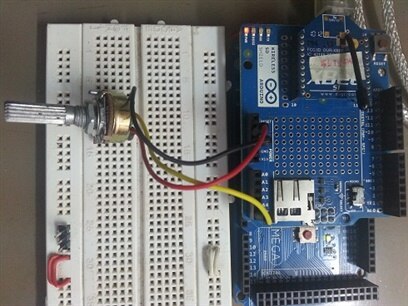

The materials used in this post including Arduino board, shields and XBee radios are just to test the UART of BBB and will not be used in the design challenge instead they will be replaced by MSP4305969 and CC110L. The left figure above is the source of data. I am using Arduino Mega with Wireless shield. The transceiver is XBee series 1. The potentiometer is to simulate analog sensor and connected to A5 of the Arduino board.

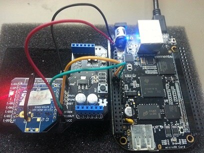

The right figure is a Beaglebone Black conncted to my computer. The XBee s1 is attached to an XBee shield for Arduino but this shield is just used as breakout board in this setup.
  • XBee pin 1 is Vcc connected to P9_3 of BBB (3.3V source) Caution: XBee operates at 3.3V and check the BBB pin mapping below
  • XBee pin 10 is GND connected to P9_1 of BBB (GND)
  • XBee pin 2 is Dout connected to P9_22 of BBB (UART2_RXD)
  • XBee pin 3 is Din connected to P9_21 of BBB (UART2_TXD)

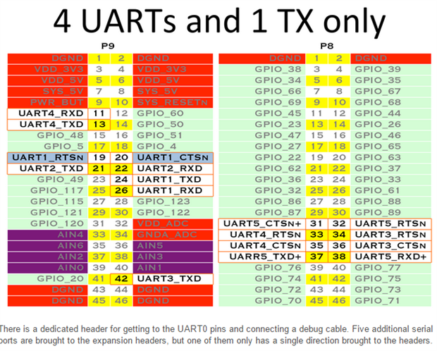

Pin mapping of BBB with UART pins highlight
http://beagleboard.org/Support/bone101image
TxRxdevice
UART0J1_4J1_5/dev/ttyO0
UART1P9_26P9_24/dev/ttyO1
UART2P9_22P9_21
/dev/ttyO2
UART3P9_42/dev/ttyO3
UART4P9_11P9_13/dev/ttyO4
UART5P8_38P8_37/dev/ttyO5

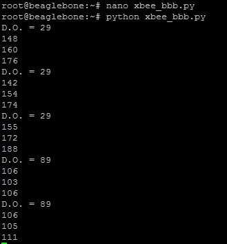

5. Run the code:
#python xbee_bbb.py
Here is the output:
6. Turn the potentiometer connected to A5 of Arduino to see change of value for  D.O. The other 3 values below D.O. are analog readings from A4,A3 and A2 of Arduino and these will be just random values since nothing is connected to these ports.
