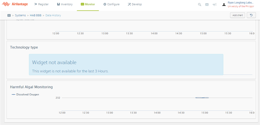

This is a continuation of Post#4 , data received through UART in Beaglebone board is displayed in terminal. My problem the last time is that I can't send data to AirVantage using MQTT since my Beaglebone is behind university proxy. MQTT is using default port 1883 as reserved with IANA. To avoid this problem, I will be using REST API instead.
In this post, data will be sent to AirVantage using Python with REST API.

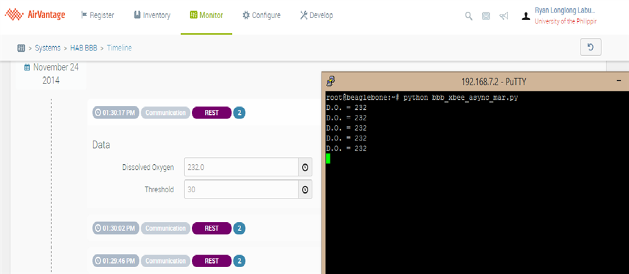

After AirVantage setup is to write a code in Beaglebone for publishing data. You will need to install "requests" to use example code below:
# pip install requests
Edited version of post#4 Python code ( added sending data to AirVantage )

  requests.post( url,
  auth=("XXXXXXXX", "1234"), #replace XXXXXXXX with Beaglebone serial number
  data=json.dumps(data),
  headers={'Content-type': 'application/json'}
  print 'D.O. = %d'%sensor_data[1]
xbee = XBee(serial_port, callback = print_data)

Run the python code in Beaglebone and monitor updates in AirVantage cloud.
Data History: D.O. chart for last 3 hours
