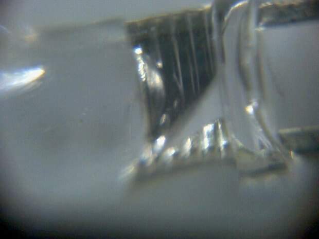

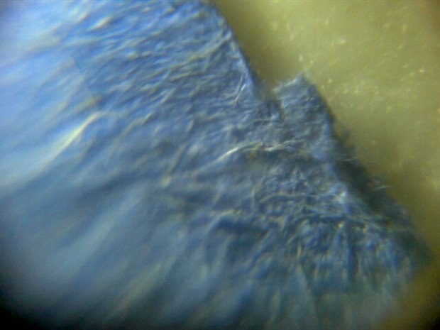

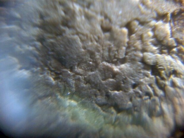

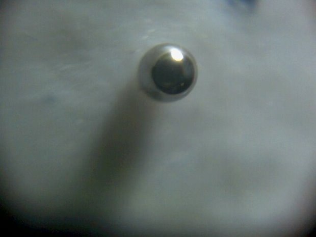

I have the microscope working!! I have it at about 80X, it isn't up to the power we need yet, but it works great. I took apart some old cameras to salvage their lenses (Don't want to waste) and attached them to a web camera. So far it is just cardboard and duct tape (My dad is right, duct tape is for everything) but I got some good photos from it. To run the web cam we (actually Dad) programmed the Beaglebone Black to run a program called "Cheese". I looked it up on-line to see what would work for running the camera and came across this program (I also liked the name!!).
Below are some pictures I took through the microscope with a description of what your seeing.
First is a magnified LED light. You can see the close-up of the inside quite clearly!!
Next is a picture of cork.
While I was looking for things to magnify I found this tiny ball of solder on my dad's workbench (His bench is a mess and he complains about my room)
This last photo is of a piece of construction paper. I wanted to take a picture of my dad's workspace (To show how messy it is) but he said NO!!

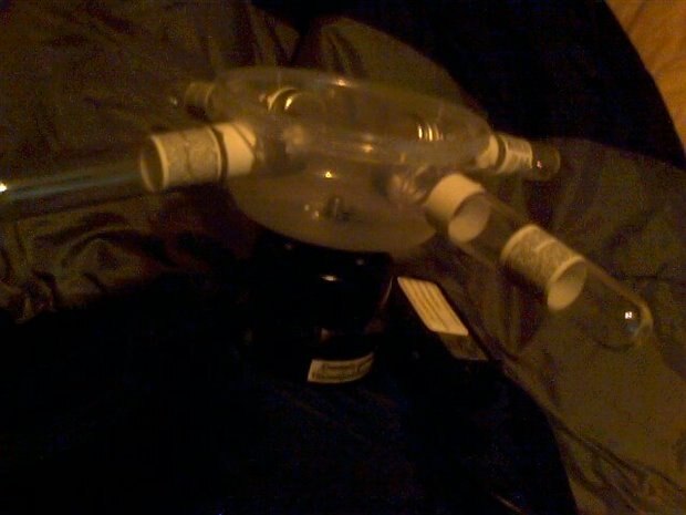

Next is the centrifuge, we ended up building our own as we are still waiting for parts. With time going by fast we decided to build one so we can complete on time. This was driving my dad crazy, such an easy machine but how to make it safe and balanced. I found a small fan that had one of the fins broken (Salvage parts, no wasting). So we took it apart and got the motor and speed control, added a hard plastic storage container and 4 vials. Attached is a picture (Without safety cover so you can see).
I took the picture with the web cam attached to the Beaglebone (No lenses to magnify). The centrifuge spins fast (We need to calculate speed yet) and is very well balanced. There is no wobble and the vials are very secure. We don't turn it on without the safety cover attached. This weekend we will test how well and long it takes to separate particles to look at. There will be lots of photos and a video of this part of the project working.

    mcb1 over 11 years ago +1
    Chrystal This is progressing. You will have noticed that as you increase the magnification, the depth of field (part that is in focus) reduces. You could try experimenting with reducing the diameter of…

    Hi Chrystal and Dale, You have made very good progress. mcb1 is right an F stop will help with the depth of field and the blur at the edge of your picture but might require a brighter illumination. It is great to see an application of electronics to biology, something we don't see too often here. I will watch for future posts.
    Chrystal
    You could try experimenting with reducing the diameter of the back of the magnification lens.This may reduce your overall image size (if you are using the full size) but may be sharper.
    Each reduction will also reduce the amount of light, until the image sensor runs out of light, at which point you will need to add external subject lighting.
    This link might help to achieve a better DOF when you go higher than 80x magnification.
    http://www.cambridgeincolour.com/tutorials/depth-of-field.htm

    the centrifuge looks awesome.
