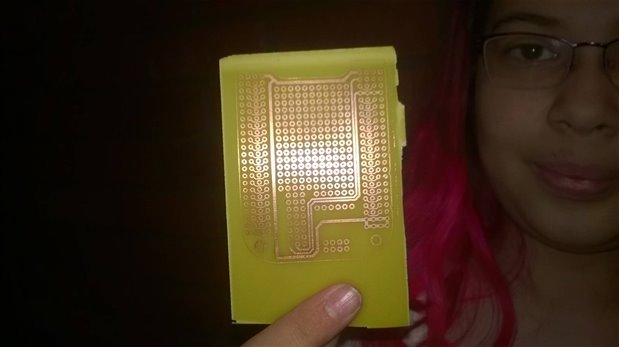

Chrystal was wanting to make a PCB cape for the BBB, so we decided on making one for developing. She searched for information and spent hours on CadSoft to create this board. She used an iron-on transfer that was printed out on a laser printer. After printing out about 7 sheets she finally got the layout correct (I turned out great). I am so proud of her accomplishments on this project, I feel her future will be great.

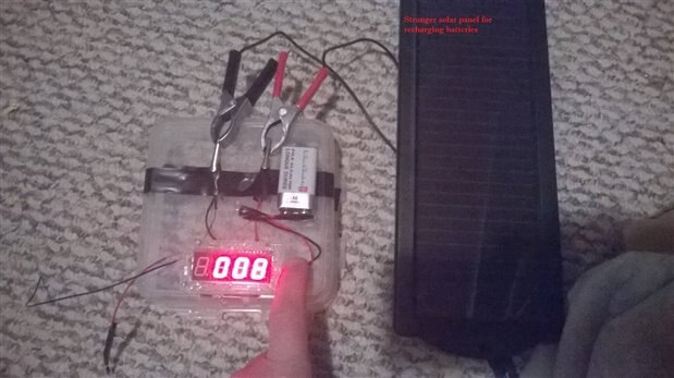

We got a better solar panel which gave us 11-12 Volts for recharging the batteries and running the centrifuge. I don`t have pictures of the recharge station and centrifuge as they are on a different camera and I couldn't`t download them today. I will upload missing photos shortly.

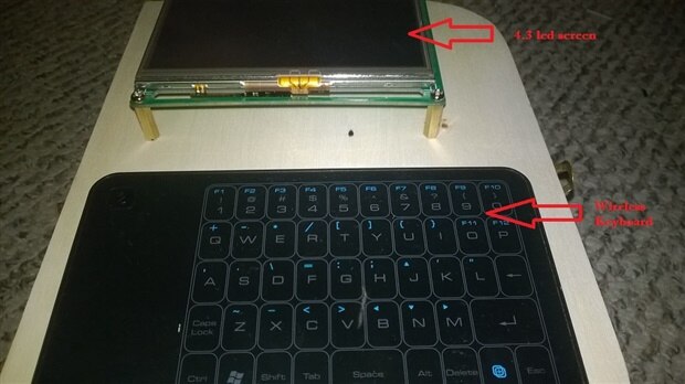

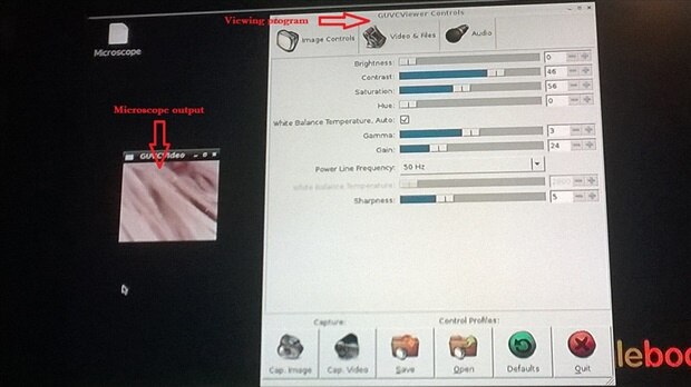

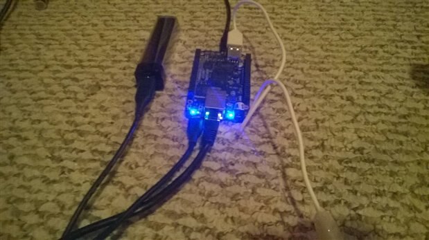

We attached a wireless keyboard to the BBB and Wifi as well as the 4.3" LCD screen. The Wifi picks up the CC3200 for transferring the sensor information. I still have to reprogram the LCD screen as I had to re-flash the BBB when a programming error I made wiped everything. I thought I bricked the BBB but luckly it wasn't that bad. I didn't like the demo LCD cape OS, it was basically just a demo and after working on it for a week I re-flashed it with Debian and had it like a regular monitor. Programming it to work like a monitor was quite a job and when I re-program it I will give details on how to do this (With lots of pictures for others interested)

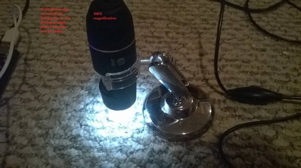

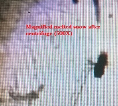

The microscope works very well, unfortunately the one Chrystal made wasn't powerful enough to view bacteria. She got only 100X power and had issues on focusing it. I am real proud of how well she thought out the whole project with the biology idea involved. The new microscope that we bought made a huge difference, Chrystal uses it often to check out how dirty the water is. The centrifuge works good, a professional one would be perfect but the one we made is good for now. We have to have it running for 40 minutes for separation of particles. Each tube has to be weighed so each one is equal to keep it balanced.
