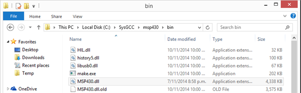

5. Get a copy of the latest MSP430.dll and paste it to GCC folder C:\SysGCC\msp430\bin

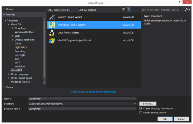

8. Create a new embedded application by following this tutorial.

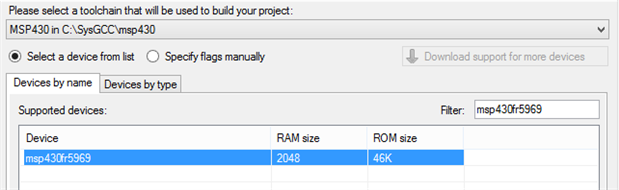

However, we will be doing some things a bit different, that is when selecting the MCU type, select MSP430FR5969 instead.

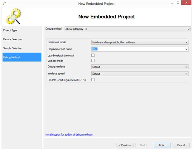

9. Continue clicking on the Next button until prompted to select the Debug method.  Use JTAG (gdbproxy++) and set the name to USB.
