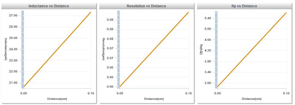

One other thing I checked out this week was the LDC1000 webbench tool. It is useful to get a ballpark idea of your system requirements, but I don't think it is very suited for precise calculations. It's also pretty limited because there are only three materials to choose from and you cannot change the thickness of the metal. This figure shows what is pretty much the limit of the LDC1000 if you use the webbench tool:
As you can see on the second graph, the resolution is almost linearily dependent on the distance of the target. At half a millimeter we still only get a resolution of 50nm, which is not enough according to my previous calculations. Even worse, the webbench presumes the use of stainless steel, which has a much higher permeability, so Aluminum will probably have a worse resolution. I'll still try to see what I can get out of the circular stretched membrane setup, but if the resolution cannot be improved or the displacement increased I will have to look for some other solution. A possible improvement might be the use of a wound coil or a coil with more layers, but I haven't found much information about that yet. One other thing to improve the resolution is the use of a very high sample rate and interpolating the results, but this wouldn't be a real improvement of the basic sensor system.

    Hi DAB,
    Thanks. I hope I can get a decent result out of all this.
    The resolution is not actually linearily dependent over a large range, just for small distances.  For example if we look at the resolution over a range of about 1cm it looks very non-linear (it looks to be inversely proportional to Rp). But when we are only looking at a very small region it looks almost linear. The non-linearity is inherent to eddy-current position sensors. I think you can get the best resolution by choosing a coil such that the change in Impedance is as large as possible over the required range. That way you can set Rpmin and Rpmax to a value that results in almost a full 16-bit range. It doesn't seem very easy to calculate all these things, even if you have all the required parameters. I'm not sure I understand what you mean by setting the sensor up to a log scale. Do you mean changing the relation between Rp and the distance? I have thought about changing the shape of the target or the coil to achieve a higher resolution, but I don't think that is what you meant.
    https://dl.dropboxusercontent.com/u/42920327/week5/ldc1000_res.png

    Hi Sammy,
    Good post.
    Is the linearity of detection distance due to the algorithm in the sensor or just the signal response from the software?
    I wonder if you can set up the sensor to a log scale so that you can get higher resolution over a smaller range?
