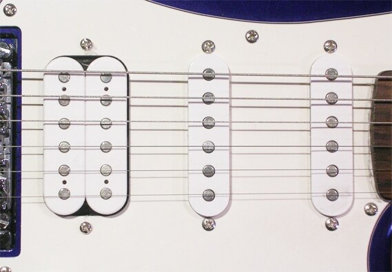

Playing some electric guitar I never liked that good pickups can be extremly expensive. From the engineer's point of view, I did never understand why there are only few active pickups and why not imtegrate the Amp and ADC into the guitar (also thinking of wireless transfer using TI pure path transceiver chip). And rare earth elements used in good magnets are not the best solution when it comes to emvironmental issues!

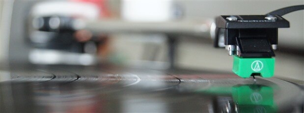

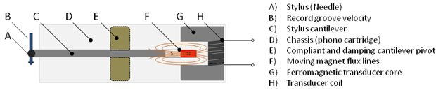

Wouldn't it be then not a nice approach to sense the strings directly ? The LDC1000 would offer enough speed and sensitivity, but the coil setup would be somehow challenging. Maybe ... I schould take a look at turntable pickups first ...

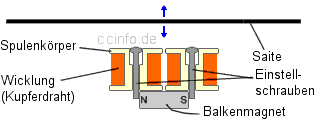

    Probably, it will sound different (since the two methods are measuring in different ways - an electric guitar cuts a certain amount of flux (so the magnet characteristics have an impact too) as the wire vibrates (so it depends on the wire position as it vibrates), that may be very different to the field from the coil with no magnet, using the LDC1000. I'm sure it will work, but as a result the sound may have different harmonics (which are probably the reason expensive pickups cost a lot).

    Good idea!  Why not just separate the pickup coils and use those for your inductor.
