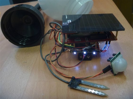

Solar IoT garden lamp - weather station - intrusion detector
In my first blog entry I envisioned solar powered garden lamp with IoT connectivity and have recently started building it.
Solar driven garden lamps often can not supply light through all the night. PIR motion detector allows to switch on LEDs only when someone is nearby. Such lights are very practical at the house entrance door when trying to find keys.

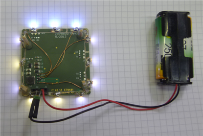

12 superbright white LEDs are drawing 400 mA from 2xAA 2500 mAh rechargeable batteries. Actually, 2.4V is not enough to drive a white LED. I used step-up board from Wurth Electronics that was supplied in another roadtest (wireless challenge). Each 3 LEDs are connected in series and there are four such series. If necessary, it might be possible to program PIR alarm mode going to a mobile phone. Everything including the solar panel is hidden inside the white glass ball. Solar cell is placed on the upper part inside the ball.
