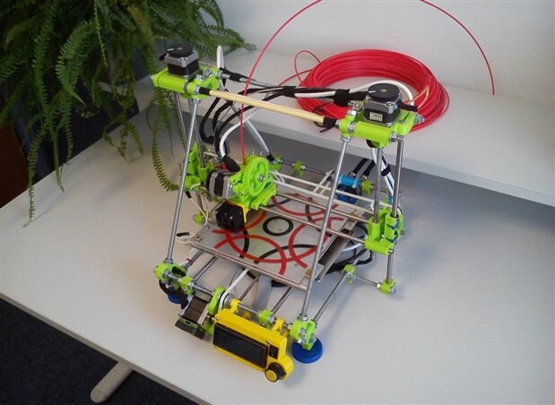

At begin I want thanks for my wife (for patient) for my friend Jonatan (for 3D printer ) for Daniel Defoe (for very fast realizing my orders),
for my young daughter (for permanently hidding device components image  )

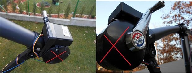

1. Introdution
competition is ending
I learnt a lot, but finally I designed my iot_umbrella device

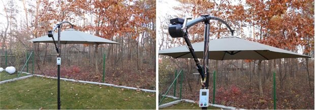

Full project include: anemometer, gps module, solar charger, umbrella controller

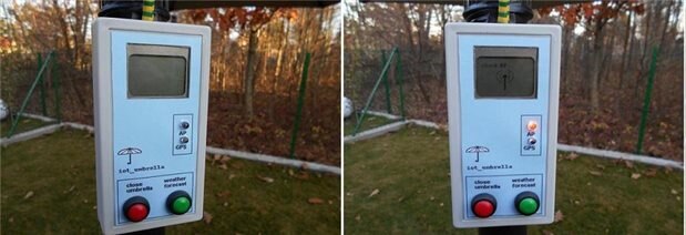

Umbrella controler is mounting on umbrella
umbrella with mounted all components look like below

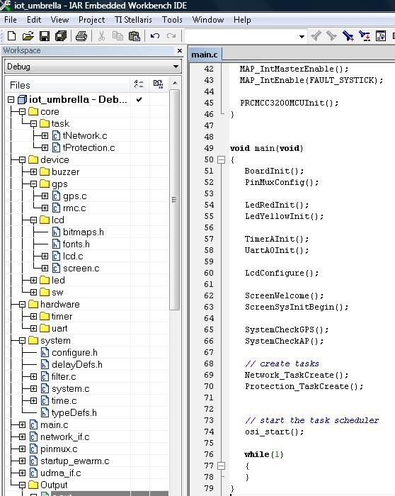

4. Software
Project is written in „C” language using IAR EW for ARM. In project I described lcd, gps, anemometer, buzzer, leds switches devices. I created two RTOS tasks (freeRTOS is used):
  • network task
  • protection task
In network task device checking acces point connection, reading weather forecast data, updating umbrella statistics. In protection task device closing umbrella ( anemometer event,,, to strong wind detection, or user pushed close umbrella button ) and checking umbrella open event ( user opened umbrella,,, umbrella state is changing form closed to opened).
Device configuration is defined in „configure.h” file located in system folder. In this file user can set network connection parameters ( AP name, password), weather forecast settings (state wind, temperature, location city name), plot.ly configuration data (user account name, user account password), sntp server name and gtm time zone.
User can compile project in one of two options: with gps module usage (project->options->C/C++ Compiler -> Preprocessor -> Defined symbols-> and add GPS_IN_USE) or without gps module usage (project->options->C/C++ Compiler -> Preprocessor -> Defined symbols-> and remove GPS_IN_USE).

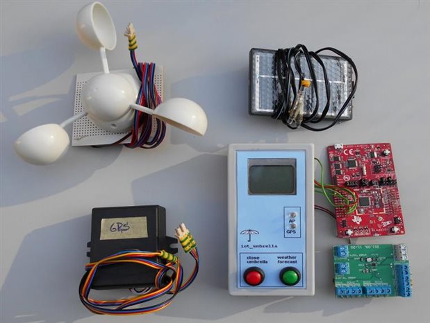

In my umbrella project I designed:

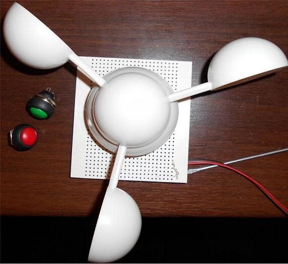

1. anemometer
2. gps module
3. solar charger

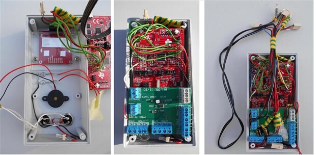

4. umbrella controller
all devices are shown  below in progress is umbrella close mechanism I described it in section number 5.6
solar charger and cc3200 devboard are mounted in controller box, additionally in box i  mounted one  buzzer, two switches and two leds and connection wires

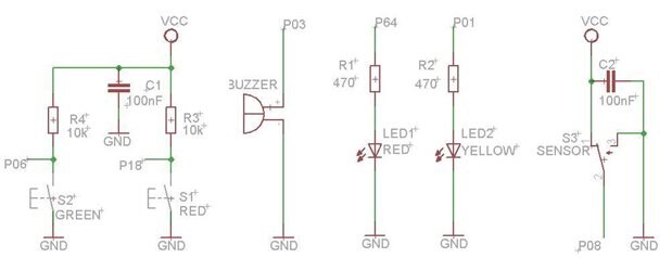

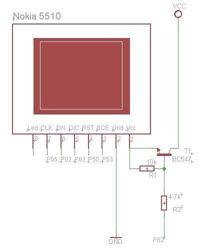

5.1. I/O's
In project are used:
  • two switches (red – umbrella close, green – weather forecast)
  • two leds (red – AP initialization error, yellow – GPS reading error)
  • one buzzer (emergency alarm before umbrella close)
  • one open umbrella sensor (based on switch). Schematic below.

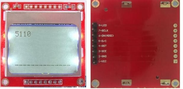

5.2. LCD
In project I used lcd from nokia 5110 (PCD8544 driver), It is monochrome graphic lcd with resolution 84x48 pixels.
I used ready devboard
Communication with lcd is done via SPI ( in one side mc->lcd ) I wrote software spi algorithm (code below )

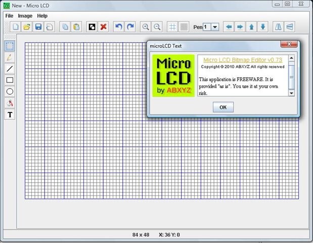

In project I use lcd in text mode but mostly in graphic mode
I am printing: system init screens, weather icons, and weather forecast emoticons.
Bitmaps are designed in freeware software: micro LCD

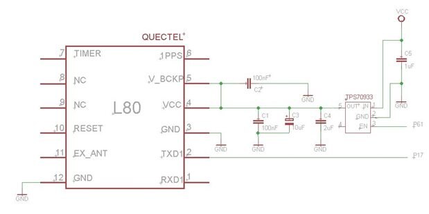

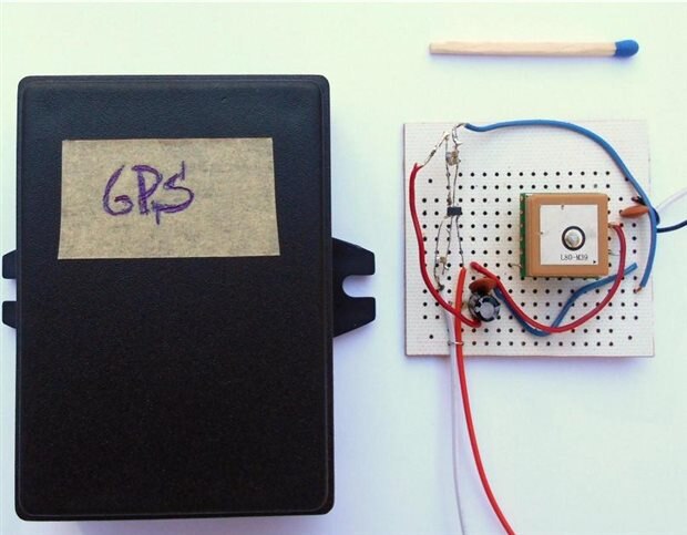

5.3. GPS
In my umbrella project I used gps module. After start  device turn on gps module and waiting for geographic position . Latitude and longitude values are used in weather forecast algorithm.
If user dont have gps module, then he can turn off gps positioning function in umbrella code (c/c++ compiler -> options -> proprocessor -> defined symbols ,,, and remove GPS_IN_USE ). After that user must set name of city where umbrella is located (definition in configure.h file). When gps module is turn off, weather forecast alghoritm working using city name.
In project I used Quectell L80 GPS module with an embedded patch antena, but umbrella software is compatible with every gps module working in NMEA 0183 standard.
CC3200 communicate with L80 via UART (9600bps, 8N1).

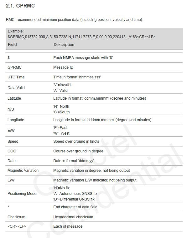

On the  L80 NMEA output are avalible GPRMC, GPVTG, GPGSA, GPGSV, GPGLL GPTXT  commands. In umbrella software I analize one command: GPRMC.
I wrote simple state machine. In  am checking L80 output NMEA chars and I am wait for „$GPRMC” string. If I found this string I am checking gps state (A-active, V-inactive). If gps position is active ( A state) then I am waiting form end of gprmc command. Then I check command CRC. If CRC code is corected then I finishign gps positioning procedure and I read latiotude and longitude values.

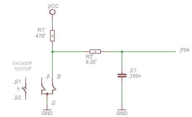

5.4. Anemometr
Umbrella should be protected against damage. What can damage umbrella  ... of course strong wind ! So II am start developing wind sensor (anemometer)
Anemometer based on encoder and frequency measurement algorithm ( timerA in capture mode )

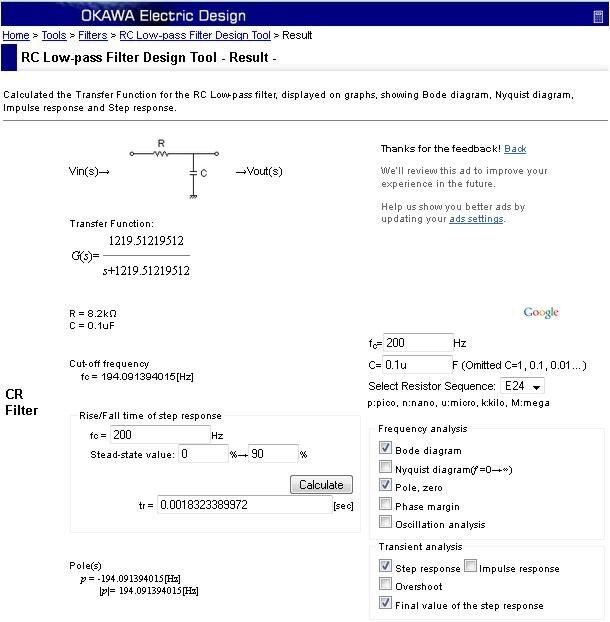

In code I implemented software and hardware frequency filters
Hardware LF filter  ( 200Hz Fc ) was created by: http://sim.okawa-denshi.jp/en/CRtool.php

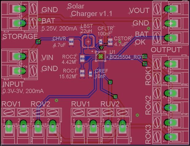

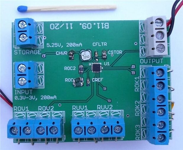

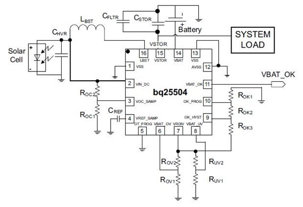

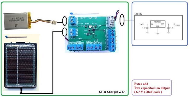

5.5.Power supply
For umbrella project I build my own power supply system.
  • solar panel (3V, 80mA)
  • storage/battery element (LiPo rechargeable battery from Fuel Tank BoosterPack)
  • my own universal solar charger device (based on TI bq255040 )
  • TI TLV70433 LDO (3,3V, 150mA)

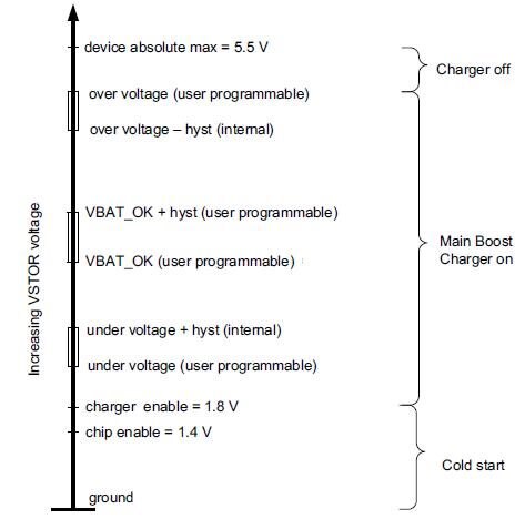

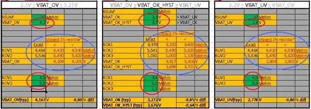

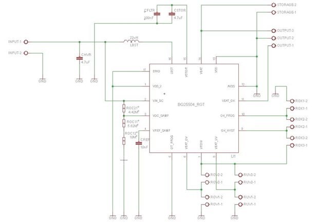

Designed by my universal solar charger is based on TI bq25504
Solar charger parameters are configured by resistors.
  •    battery over voltage protection value (ROV1, ROV2)
  •    battery under voltage protection value (RUV1, RUV2)
  •    battery ok value and battery ok hysteresis value (ROK1, ROK2, ROK3)
Maximum power point tracking value is set on 80%. Battery thermal shutdown protection value is set on 65”C.
In my solution I configured values:
  •     over voltage: 4,2V (ROV1=4,5 M ROV2=5,5 M)
  •     under voltate: 2,8V (RUV1=4,5 M, RUV2= 5,5 M)
  •     battery ok.: 3,3 V battery ok hysteresis 3,7V (ROK1= 3,4 M, ROK2= 5,5 M, ROK3= 1,1 M)
Bq25504 working like on shematic below:
During choosing rezistors paremeters very  helpfull is TI spreadsheet:  bq25504_Design_Help_V1_2.ods I used it in my work.

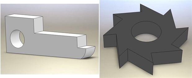

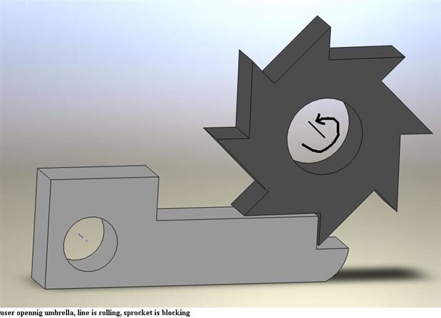

5.6.Close mechanism
Umbrella is opened always by user ! User manually opening umbrella - using knob.
Umbrella could be closed when user pushed SW1 (red switch – umbrella close) or when anemometr detecting too strong wind. When umbrella is closing – close mechanism is using. I designed this mechanism but actually I don’t have it. Mechanism must be printing on 3d printer. My friend Jonatan have 3d printer (foto below) and he want print spares (sprocket and latch) for me.
I designed sprocket and latch.
How it will be works ? When user opening umbrella line is rolling, mechanism is automatic blocked (look on foto below).
For unlock mechanism I will be user servo. Servo will move latch after that line will be unrolled and umbrella will be closed (look on foto below).
Close mechanism (when spares will be ready) I will be mounted here:

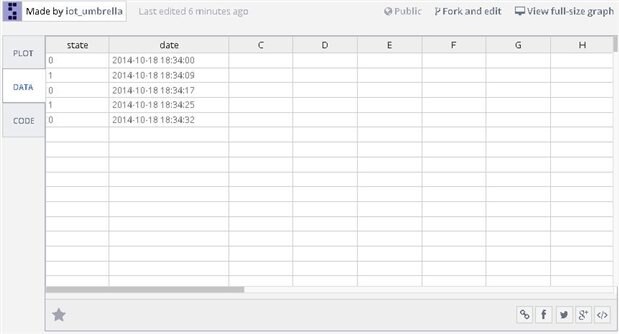

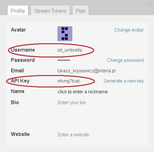

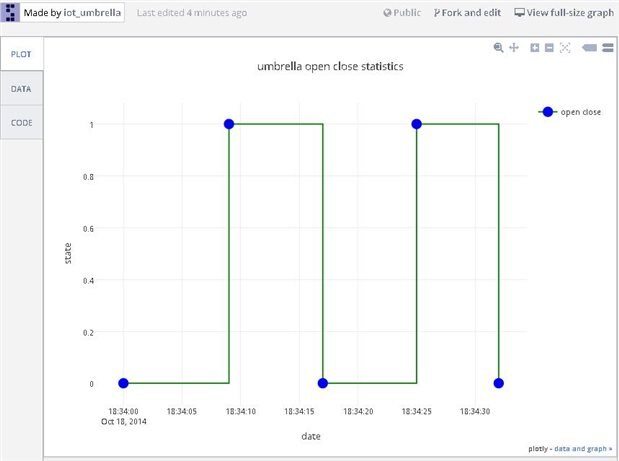

6. Plot.ly
In project I used plotly for displaying umbrella statistics.
Device cc3200 monitoring two events:
  1. open umbrella (user can manually open umbrella)

My testing plot is showing below. On next picuure I am showing plot data.
How I done it .
  1. I created account: „iot_umbrella” on plot.ly (registration is for free)
  2. I readed my user KEY: „nhvng7txac”
  3. I started codding. Usefull was arduino examples, and plot.ly args documentation.
Data into plot are sending by HTTP using POST method in SetPlotLyData(int iSockID, uInt16 value); procedure (code below)

  • plot type: scatter, plot mode: lines+makers, line shape:hv
  • plot line color: green, plot line size:2
  • maker color:blue, marker size:16
  • plot title:umbrella open close statistics
  • xaxis title: date, yaxis title:state
Connected together (prefix and postfix) strings are send into plot.ly service. In response server return plot adress. My plot adress is: http://107.21.214.199/~iot_umbrella/16 ( Full response from server device printing on debug uart canal (9600 8N1), here user can found plot adress and use it in aplication)
