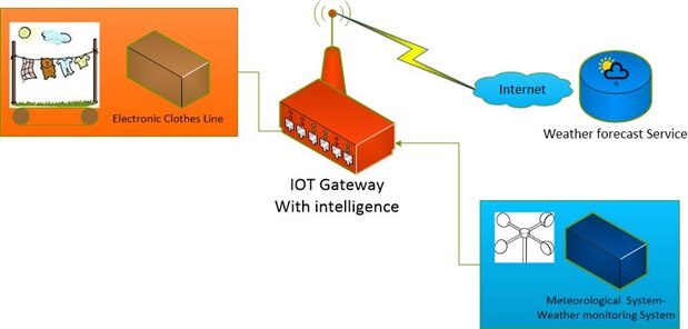

I will be trying to accomplish the solution to one of the above stated. The system consists of the following components:
  1. MET System: A meteorological system composed of an anemometer(wind speed sensor), rain sensor, light sensor and temperature sensor will monitor param
  2. Electronic Clothesline: A mechanical arrangement which uses a motor and pulleys to control the location of clothes hanging on a line.
The board will talk to an online weather forecast system to determine if the winds are just temporary or part of a storm. This will prevent the clothes line from opening and closing everytime there is a gust of wind.
(Proposed System)
Additionally it will talk to an MQTT server posting status and receiving control messages. I am not worried about security right now since I have a different plan for that. I will be focusing on the implementation and the code.
