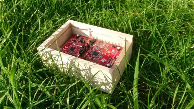

Despite what the uniflash quick start guide tells you, which is there is no need to format cc3200 when you get, I believe that is the best way to avoid all the headaches and troubles of files not uploading correctly. Once I reformatted my cc3200 flash using the default format options and reloading the service pack, I was able to upload all of the files I wanted to.
Here is my cc3200 launchpad happily working outside with its batterypack. I was able to access its local web pages without problem.

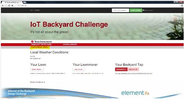

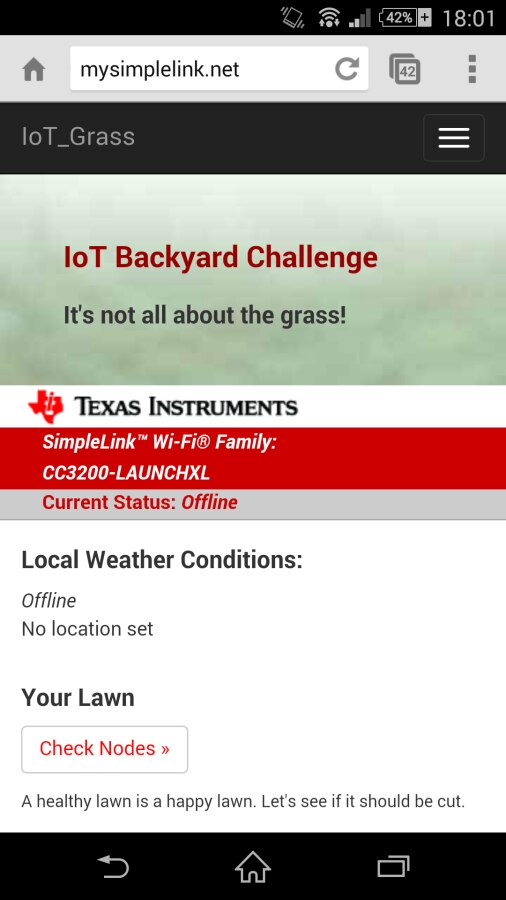

I decided to go to town with the web front end (just to see how well the cc3200 worked) and used the bootstrap template (www.getbootstrap.com). See for yourselves... my fancy screenshots attached (one image showing web page on desktop and other image showing web page through phone). So fairly pleased that my launchpad was able to upload and use the .css and .js files without problem.
So web pages aside the key challenge now is getting to grips with jquery / ajax to talk to the cc3200 itself as my cut and paste of the js routines did not get my offline / online tags to work (I suspect my class names were not aligned properly). Next I will be dissecting the oob main.c and amend to resolve these interface issues and then I will have my web browser displaying local weather and temperature etc.
