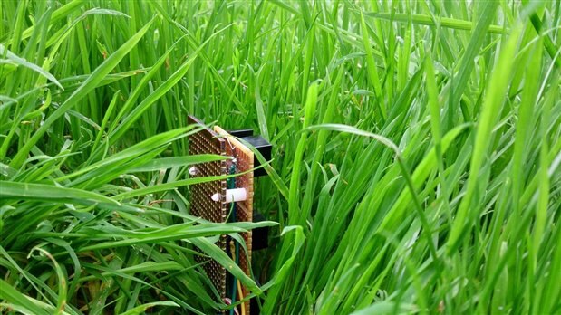

Thanks to an unseasonally warm September month I finally have plenty of long grass to work with...

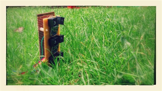

and the grass sensor node is coming along slowly but surely. Here is my first attempt at the grass node sitting in shorter grass... yes I mowed the grass too (well most of it as still need the long grass for testing).

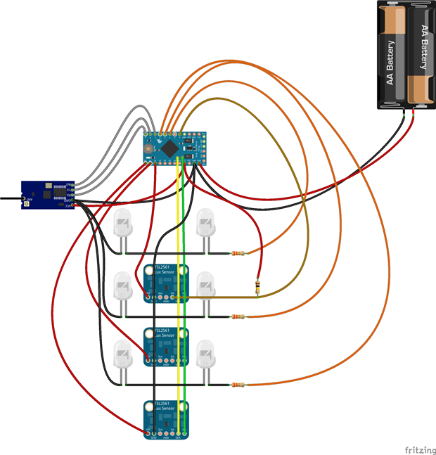

Quite a few mistakes were made on my first build attempt. Firstly, the placement of wiring was messy and then the gap right between the two boards to accommodate the battery was too narrow. I fell into the classic trap of rushing to build due to the tight deadline before thinking through the design. So word of advice, don't forget to some engineering before doing some making. I am a great fan of the Fritzing breadboard mode as this mode quickly validates your wiring layout and you get a nice visualisation too of how things are connected (2nd design of mine shown later on).
Anyhow, my first hack attempt very quickly flagged a shortcoming in my original design (so okay the rush to build did have a benefit in my case - so next tip, don't over analyse and wait till things are perfect before making something). It highlighted once again that both hardware design and software development have to be considered in tandem from the very start of a project. One feeds off the other, so don't treat as sequential steps. I had intended to use two Adafruit breakout boards, the TSL2591  as the top light detection sensor as had a greater dynamic range (to avoid saturation) and then 2 x TSL2561's for the middle and bottom sensors as these were cheaper and also one could change the I2C addresses with these boards so they would not conflict the TSL2591 (which you could not address). This seemed a reasonable approach from a hardware design point of view. However, once you start to look at the software development side, you immediately find yourself making more work for yourself trying to handle two types of I2C devices.
Hence I am now using 3 x TSL2561's, each with their own unique address (as this is possible) and all I needed to do in the software point is use the Adafruit open source library and create three instances of the class for top, middle and lower sensor. With I2C I simple join the SDA and SCL of each board and as they already have pullup resistors all the work was taken care of. As I was never planning to take continuous readings I have now decided to utilise the interrupt pin on one of the TSL2561's and set up a low light threshold trigger to wake up the grass node as I only want to take measurements when light is low (hence I will never have the saturation problem in this case). The interrupt feature is a really handy feature for my application.

Here is the Fritzing wiring layout of the node design so far:

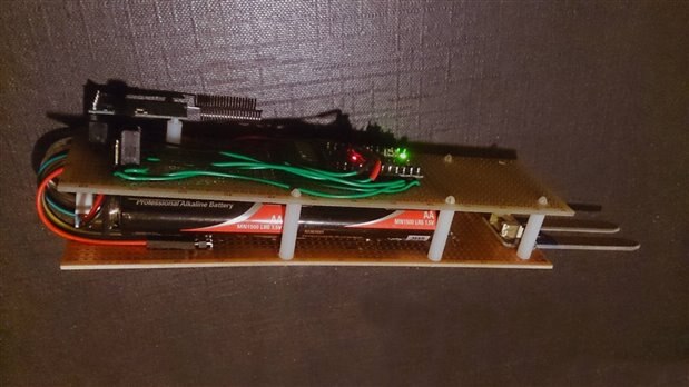

And here is the prototype all wired up and ready for its first tests:
The MCU board for the node to get me to first test of logic is an Arduino pro mini 3.3V as it has a reasonably efficient voltage regulator on board, which at least takes away that headache to get me started. However, I find putting Arduino's to sleep to really be a pain in the neck.
The node has a moisture sensor which doubles up as the means to peg the node into the ground. An optional temperature probe could also be included as the 3rd "peg" in the ground.

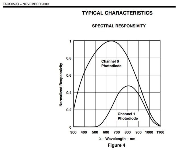

According to Spectral responsivity of light sensor (see chart) channel 1 is more sensitive closer to the 800nm range, so I decided to use two Infrared LED's at different wavelength, one at 890nm and one at 940nm to provide a better spectrum of light for the sensor to pick up. This will probably require tweaking down the line. I am also using LED's with a narrower beam angle of 10 to 15 degrees.
