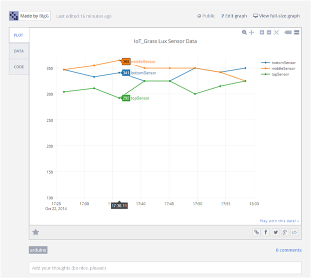

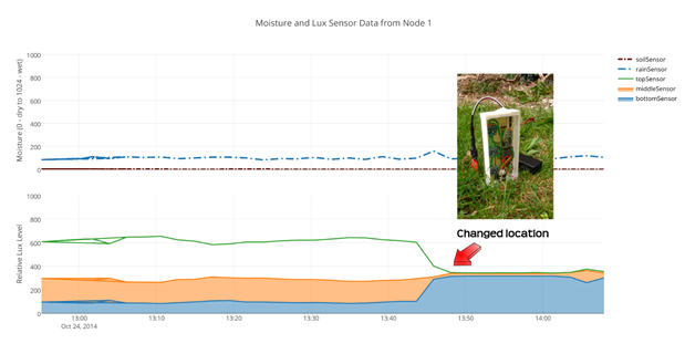

Here is another update chart. This is still pretty raw, hence some odd behaviour at beginning as was amending chart through Plot.ly, but thought to add as it illustrates what is possible with Plot.ly. This is streaming data so you get "live" analysis of your data as it happens.
Once you have some data (initialised your chart) you can go in and manually adjust the chart layout to what you want and this will be used to show streaming data. So if, for example, you want to display two different types of sensors on the same chart, you can simply select the trace of choice and change the y-axis (a bit like you would do with MS Excel) - I have illustrated this below with my moisture sensor data. You can also stack charts to show different sensors tracking the same x-axis. So in my case I have two moisture sensors streaming data to top chart and the 3 lux sensors streaming data to the bottom chart, with both using the same x-axis data. Another very important feature, and where most automated graphing systems fail, is the ability to set your y-axis. With auto-scaling you can very quickly catch yourself out by misinterpreting your data simply because the scale automatically changed.

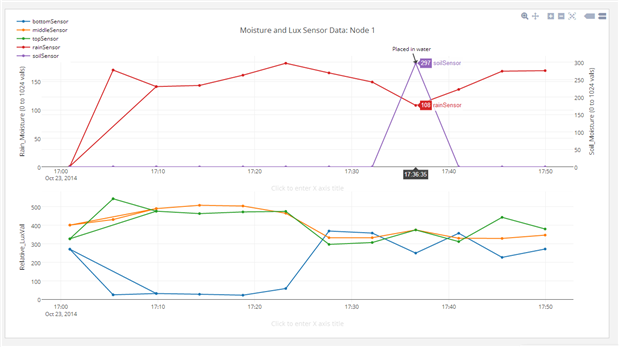

As you can see, the data is starting to show some insight. For example I covered the bottom light sensor slightly and the values dropped relatively. I placed the soil moisture sensor in some water and this climbed.... Not sure why my rain sensor is giving readings but that is just a calibration issue for later.
Over the next couple of days I should now be able to get real field data. <<BLOG UPDATE>> But here are some earlier test results, which I started today (while it is not raining :-)). At the moment I have my CC3200 being powered through USB as still changing / tweaking code. Attached to CC3200 is my H12 RF device with quarter-wave (not half-wave) wire antenna which is talking to my grass node some 30 metres away outside. If wondering what else is showing in picture, it is some external EEPROM which I may use for later (handle web-server config info etc.).

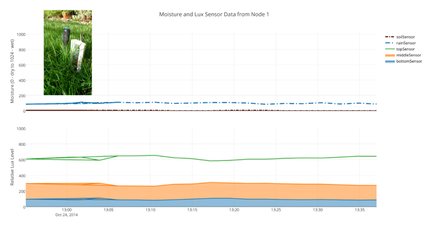

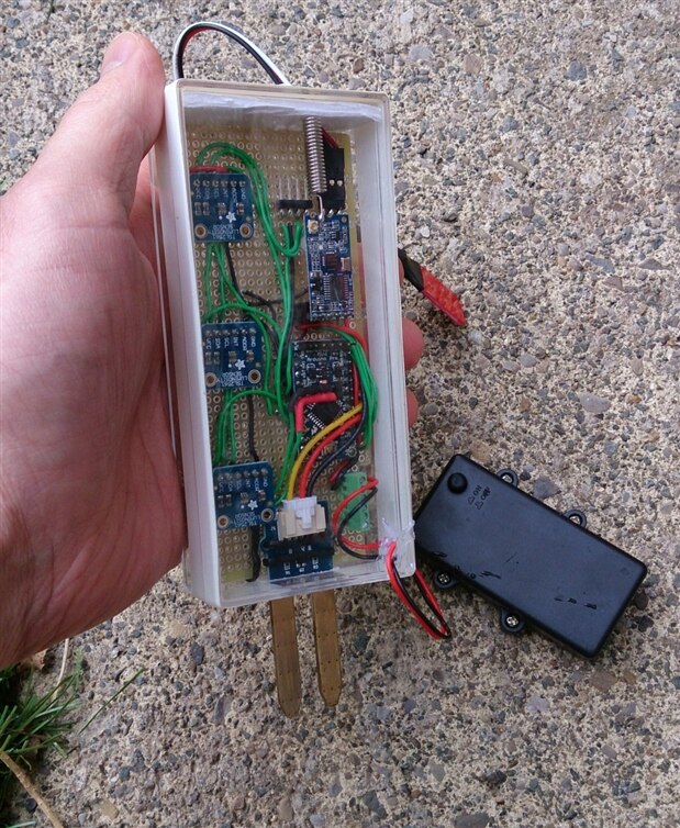

Then my new node device is now enclosed (as now need to cope with the rain) inside a $3 transparent case from SeeedStudio (Buy PS(Poly Styrene) Transparent Case - 130x60x25 mm [322060002] | Seeedstudio). Moisture and rain/water sensor also from SeeedStudio. Everything is now on one protoboard with batteries enclosed within own waterproof enclosure. I decided to leave out the IR LEDs for now. We will see how well this works over next coming days.

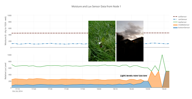

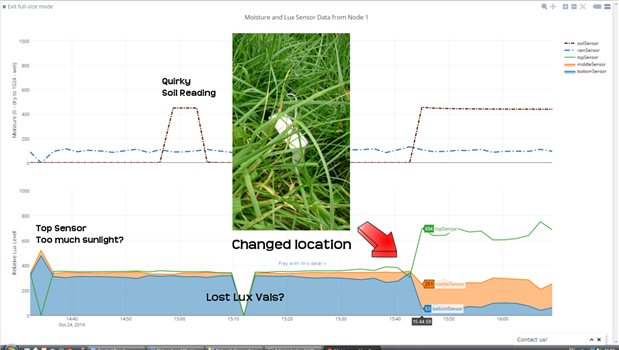

Here are two formatted Plot.ly charts showing some positive results from my grass sensor node being placed in three different locations. First location has longish grass, second location had much shorter grass height and third location it was rather overgrown. By the time I moved node to third location some interesting data values were spotted, which will require troubleshooting. Notes have been added to 3rd chart highlighting probable issues.
It is now the end of the day and the field trials have worked out quite well in my opinion, with my data streaming ok through to plot.ly and my RF devices proving quite reliable without any resilience added to the code. I thought to add this chart as it highlights how real time analysis works "on the fly". This was picked up while monitoring the streaming data through my smartphone. I was then able to quickly check and took some pictures for recording keeping and to note the time. This chart captures the issue of when light fades....

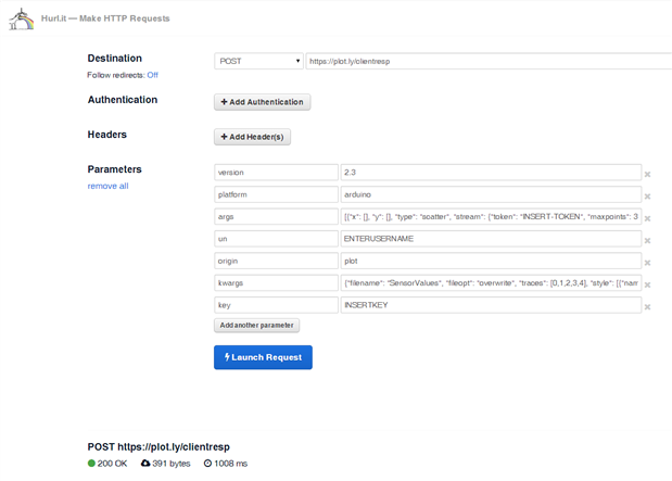

Here is a screen dump of what you can send through hurl.it to initialise your charts:
You will get your response to tell you whether it has been accepted or otherwise. If your requested has been accepted you will see this in the response body:
  • "stream-status": "All Streams Go!"
  • "url": "https://plot.ly/~USERNAMEHERE/0"     (the /0 might be another number depending on what was requested - also this format is for public charts.)
  • "message": "High five! You successfuly sent some data to your account on plotly....
