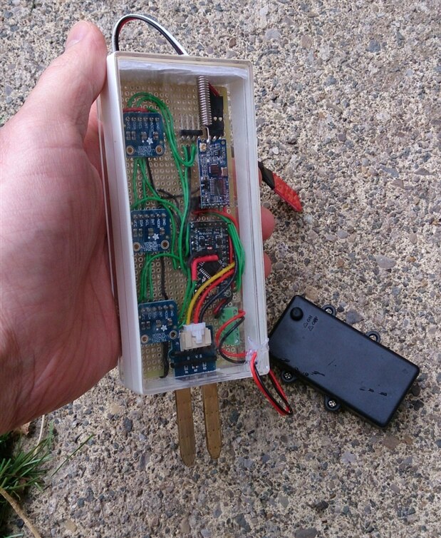

As such after tweaking here and my final grass node was eventually built using the following components (Total Cost: $75 rounded up per node)
  • Arduino Pro Mini 328 3.3V/8MHz was used primarily because of its form factor (small enough to fit onto node) and because it included a relatively efficient voltage regulator for battery power usage. It also had sufficient memory for my purposes. (Cost $9.95 from Sparkfun)
  • 3 x Adafruit TSL2561 Digital Luminosity/Lux/Light Sensor Breakout modules were used as these were individually addressable using I2C prototcol, they had the required pull-up resistors already included and the TSL2561 has very low current draw of about 0.5mA when actively sensing, and less than 15 uA when in powerdown mode (source Adafruit: https://www.adafruit.com/product/439). (Cost $5.95 each from Adafruit)
  • HC-12 wireless serial port communication module (Buy 433Mhz Wireless Serial Transceiver Module - 1 Kilometer [800132001] | Seeedstudio) was used as these are very compact, easy to use, have power transmission / power saving settings and provide good radio coverage with good distance and work through walls etc. allowing sensors which are outside to communicate with CC3200 which was inside (Cost $12.90 from Seeedstudio).
  • Grove moisture sensor was chosen only because I had some of them lying around as they are not really suitable for long term use (see picture below) and were primarily used to peg the sensor node into the ground. (Cost $4.90 from SeeedStudio)
  • A Water sensor from SeeedStudio was used to detect rain / dew in grass as I had one spare and I also made a DIY version too. (Cost: $2.90)
  • A waterproof 2xAA Battery Holder with On/Off Switch from Adafruit (Cost: $3.95)
  • A clear enclosure from SeeedStudio (Cost: $2.90)
  • A 1/2 of a prototyping board from Farnell (Cost: $7.50)
  • Sundaries such as wiring, 2 x Lithium 3.6V batteries, LED's etc. (Cost: $12)

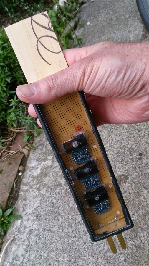

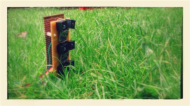

To illustrate the evolution of my grass nodes, here is the first one which did not work out due to wiring issues and was not used:
This was my second grass node, which was made using 2 protoboards and 4xAA battery holder sandwiched between, inside a DIY wooden enclosure with clear cover and some trusty Sugru (FIX THAT THING | Sugru) to help seal it (tape was added later to protect from heavy rain):
Then finally the third node was made on a single protoboard and placed inside a transparent off-the-shelf enclosure:

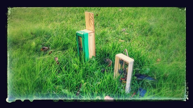

Here are the two nodes in the grass placed side by side for "photo opportunity":

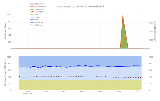

An underlying purpose of the project was to use the functionality of Plot.ly to ascertain automation criteria, such as notifying the user when grass growth is reached a preset threshold. As in previous blog, early indications have proved that Lux sensors could be used for such purposes. Other novel features have also come to light, such as monitoring Lux spikes at night (e.g. has a security application for remote locations outside where car headlines or torchlight would be detected and could trigger a notification message) or how often it rains and for how long (similar for dew point / condensation on grass through water detection sensor).

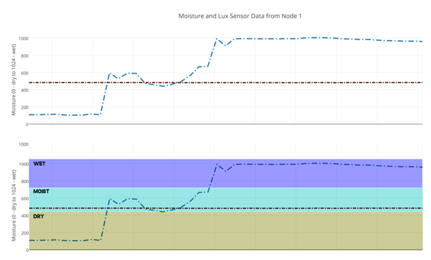

Proper application of Plot.ly can also assist the user in correctly interpreting data being streamed. I illustrate by way of example. The most common form of time series charting is a line drawn on the chart. The first common mistake made is if the scale changes on the y-axis. On Plot.ly you can fix the y-scale to ensure that ='ve or -'ve changes seen remain consistent and you also have the ability to change the scale itself from linear to logarithmic scale. Another technique which I have applied is to use colour coded bands to help you ascertain significance of delta y. These bands do not need to be a straight line and do not need to remain fixed at a certain level. Thus in my case the bands help you interpret your data
Over the course of this challenge the data streamed to Plot.ly has helped me formulate thresholds and logic that can now be used to automate notifications, alarms and alerts.

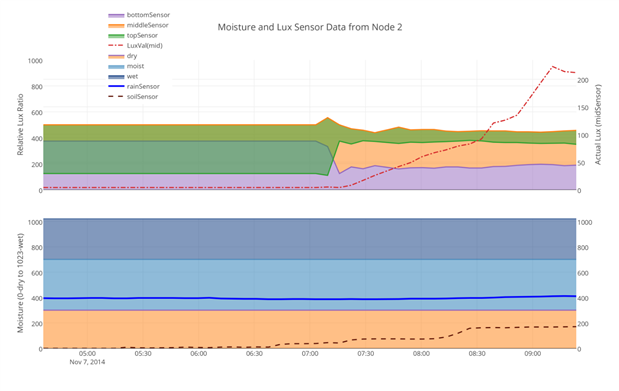

Here is one where I used a torch to see if node 1 was working ok in the heavy rain (code has been amended so that if and when very low light is detected all ratios remain at zero to prevent spurious data being shown):
This chart shows when the IR LED's turned off once daylight was detected again (only node 2 had the IR LED's would turn on if no visible light was detected). As you can see a different bottom/middle/top lux relationship exists when IR LED's were used:
