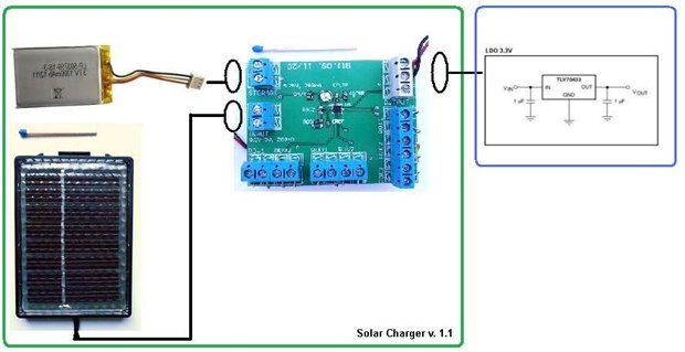

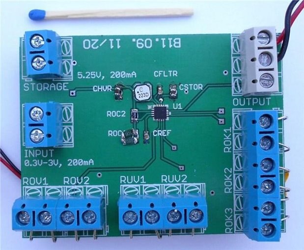

For umbrella project I build my own power supply system.
- solar panel (3V, 80mA)
- storage/battery element (LiPo rechargeable battery from Fuel Tank BoosterPack)
- my own universal solar charger device (based on TI bq255040 )
- TI TLV70433 LDO (3,3V, 150mA)

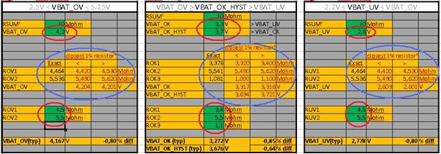

Designed by my universal solar charger is based on TI bq25504

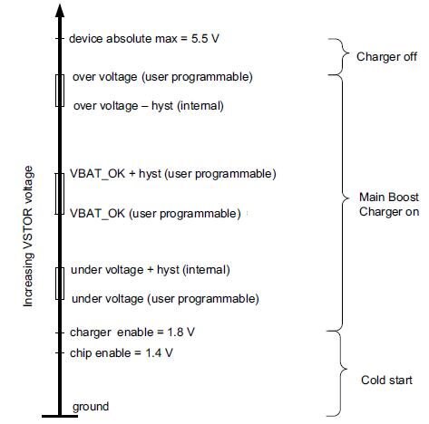

Solar charger parameters are configured by resistors.
-          battery over voltage protection value (ROV1, ROV2)
-          battery under voltage protection value (RUV1, RUV2)
-          battery ok value and battery ok hysteresis value (ROK1, ROK2, ROK3)
Maximum power point tracking value is set on 80%.
Battery thermal shutdown protection value is set on 65”C.
In my solution I configured values:
-          over voltage: 4,2V (ROV1=4,5 M ROV2=5,5 M)
-          under voltate: 2,8V (RUV1=4,5 M, RUV2= 5,5 M)
-          battery ok.: 3,3 V battery ok hysteresis 3,7V (ROK1= 3,4 M, ROK2= 5,5 M, ROK3= 1,1 M)

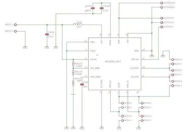

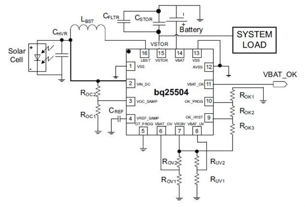

  Bq25504 working like on shematic below:
During choosing rezistors paremeters very  helpfull is TI spreadsheet:  bq25504_Design_Help_V1_2.ods I used it in my work.
In attachment I share
Bq25504 datasheet, bq25504_Design_Help_V1_2.ods spreadsheet, and TLV ldo datasheet

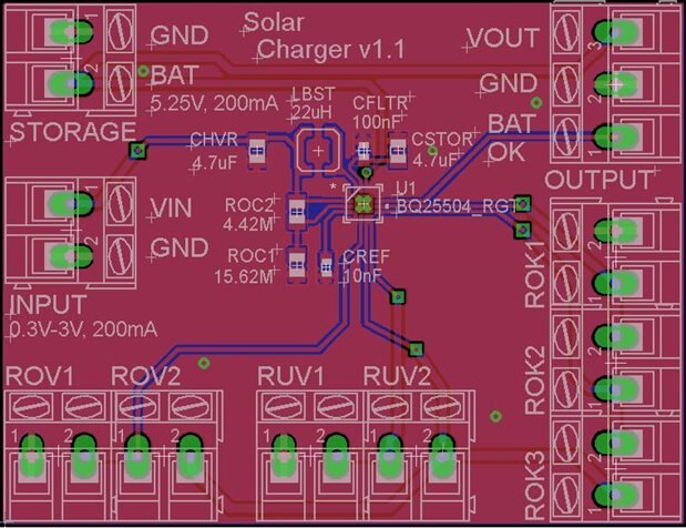

    .lukasz. over 12 years ago in reply to ipv1 +1
    at the begin I was thinking about using trimpots too, but finally I resigned from this idea,,, why ? few reasons 1. trimpots are expensive 2. it is hard to buy trimpost with resistance 10M / 5M 3. trimpots…
    I connected cc3200 to power supply
    during connection to AP cc3200 was restarted
    so on the power supply output I added two capacitors 470uF 6.3V each
    problem was solved !

    I will add place for "right resistors"
    mcb1 over 12 years ago in reply to .lukasz.
    Lukasz
    Good points about the trimpots.
    If you redesigned the board would you include room for extra resistors to allow the right setting ?
    It seems there is space for them.
    thanks a lot for comments
    P.S.
    on pcb is little mistake I will fix it soon
    ROC1 resistor have value 15.62 M (MPPT value 80% configuration)
    in real world I had problem with buy,,, so I mounted two resistors 10M + 5.62M ( mounted in series both in 805 package )
    few reasons
    3. trimpots with resistance 5/10M have  resistance tolerance like 5M (+/-)10% 10M (+/-)30% or greater
    In my solar charger I used ark2 for mounting resistors, so solar charger is universal,
    in final product ark2 should be replaced for resistors mounted on pcb board
    P.S.
    for example
    5.5M value I create with connecting together 3 rezistors  (5M + 200k + 200k)
    4.5M value with connecting together two rezistors (4.3M + 200k)
    it  is easy in use,,, and universal
