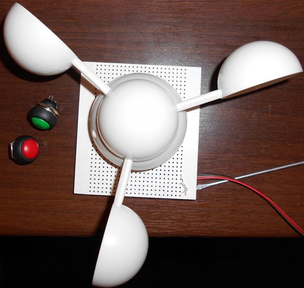

my umbrella should be protected against destroy
what can destroy umbrella  ... of course strong wind !
so I am start developing wind sensor (anemometer)
below is real foto of anemometer elements (additionally is mounted gps module):
up this time
1. I bought all needed elements ( turbine, encoder, wires )
2. I wrote frequency measure algorithm (timer in capture mode)

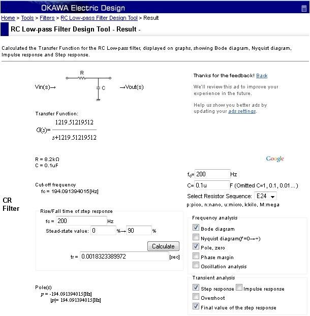

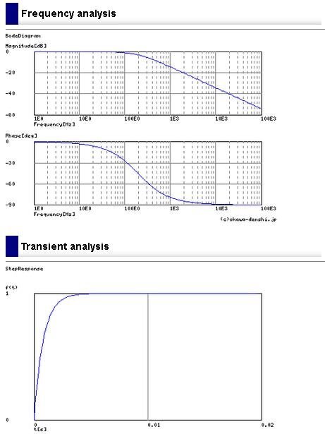

update 03
hardware LF 200Hz Fc filter
created by: http://sim.okawa-denshi.jp/en/CRtool.php

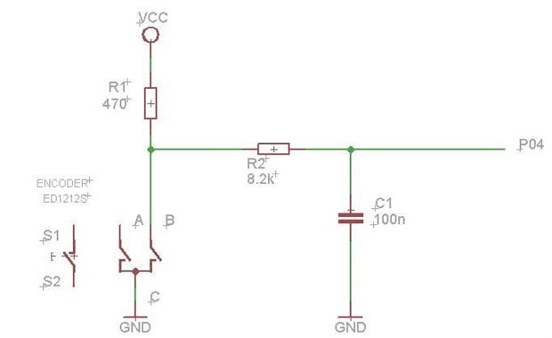

update 04
compleate schematic
- encoder ED1212s
- pull up rezistor
- lf 200Hz filter
