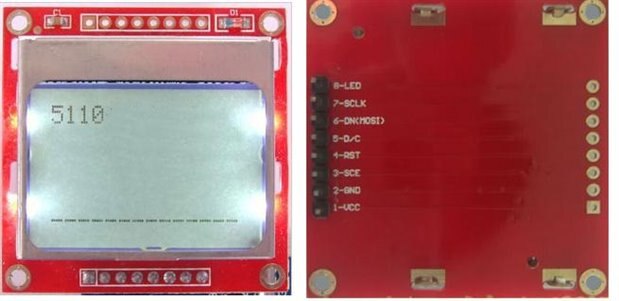

In project I used lcd from nokia 5110 (PCD8544 driver),
It is monochrome graphic lcd with resolution 84x48 pixels
In used ready hardware ( foto below )

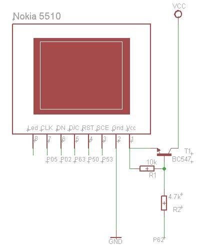

and connected it into CC3200 LaunchPad ( schematic below )
Communication with lcd is done via SPI ( in one side mc->lcd )
I wrote software spi algorithm (code below )

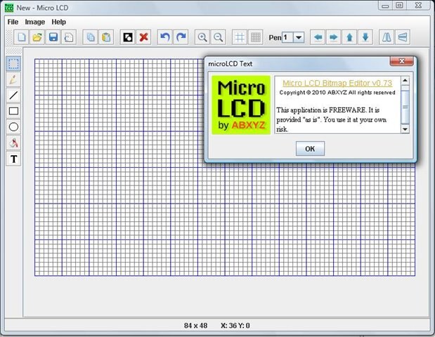

In project I use lcd in text mode but mostly in graphic mode
I am printing: system init screens, weather icons, and weather forecast emoticons.
Bitmaps are designed in freeware software: micro LCD (in attachment)
( Firstly I wrote my own bmp converter, is somebody want I can share it )
