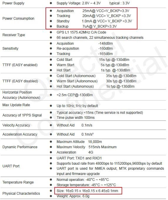

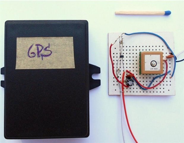

In project I used Quectell L80 GPS module with an embedded patch antena, but umbrella software is compatible with every gps module working in NMEA 0183 standard.
L80 is very good module based on MTK chipset. L80 is „low power” small and combines with many advanced features including EASY, AIC, LOCUS, AlwaysLocate  and  Antenna Advisor. These features are beneficial to accelerate TTFF, improve sensitivity, save consumption and detect antenna status for GPS system. The module supports various location, navigation and industrial applications including autonomous GPS, SBAS (including WAAS, EGNOS, MSAS, and GAGAN), QZSS, and AGPS.

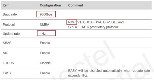

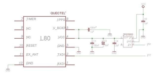

CC3200 communicate with L80 via UART (9600bps, 8N1).
The L80 module supports 2 protocols:
- NMEA – positioning data ( output )
- PMTK – gps module configuration ( input )
  In umbrella project I dont  use PMTK protocol. L80 working with default configuration.

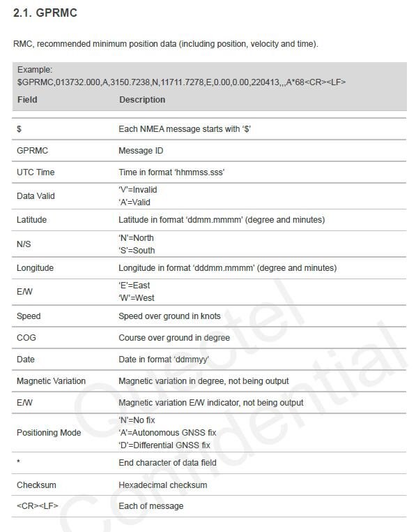

On the  L80 NMEA output are avalible GPRMC, GPVTG, GPGSA, GPGSV, GPGLL GPTXT  commands. In umbrella software I analize only one command: GPRMC.
I wrote simple state machine. In  am checking L80 output NMEA chars and I am wait for „$GPRMC” string. If I found this string I am checking gps state (A-active, V-inactive). If gps position is active ( A state) then I am waiting form end of gprmc command. Then I check command CRC. If CRC code is corected then I finishign gps positioning procedure and I read latiotude and longitude values.
