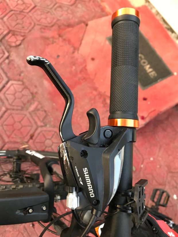

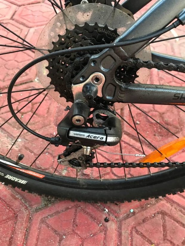

During the testing of the assembly which held fine I met with a Accident image image on my cycle image Damn those Disk Breaks .
I have got More, but I am avoiding uploading due to the content of the images image
As humiliating it would sound Nothing much happened to the stm32 but the Nextion Display got damages and I myself got a bit damaged image
