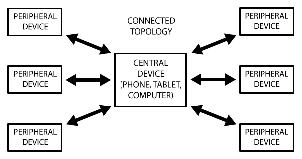

That being Cleared, BLE being Point to Point Communication protocol is organised  into 2 Main Roles Client / Server OR Peripheral / Central  OR Slave / Master
These means out of two devices one will me Master and one Will be Salve. The Master will control the Slave (Ohh This sounds more like 50 Shades of Grey !!! ***. !!)
These 2 profiles Majorly are known as GAP or Generic Access Profiles for you guys with BigAss Specks image image image
(Thanks to LadyAda for this Image)image
Moving on, the devices we usually implement as a End user device is a BLE Peripheral / Slave / Client device. So everything now on will be based on this statement.

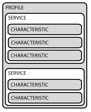

So, In a Client Device How To send data to other Devices ?
Well, to ease things up Bluetooth implements a Service / Attribute Structure.
Puzzeled ??
Don't Worry, Let Me Explain.
Lets say you want to order a Brand New iPhone X/TEN/10/ Whatever !!!! Online image I would prefer flipkart/ Amazon image
So you would like to go to a Website that would Sell you the Item ?? like Amazon or best buy !! this is our Seller Service
Now Once you land up  at Amazon You would like to go to the Mobile Section who offer Mobile Sale Services !! This is the Characteristic or Attributes
Now We would like to  Go to the iPhone Section which would contain information on all iPhones !! This is the values in the Characteristic or Attributes
All of the Above is Geeky Known as GATT or Generic Attribute Profile
Refer this diagram for ease of understanding
Finally the Values which we will play with are in Name Value pair, i.e. UUID, VALUE.
