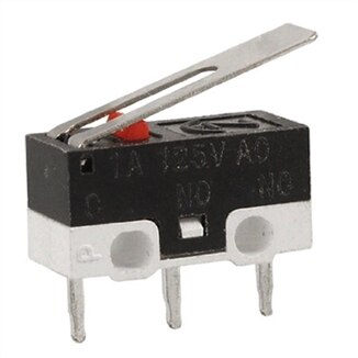

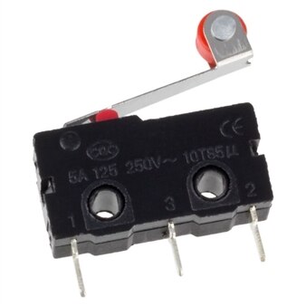

Method - I Using a Limit Switch image
The easiest method I came up with is using a Limit switch something like this
The Idea was to tie a small wooden piece to the spokes of the tire and the limit switch to the tyre frame so when ever the tyre rotates, it will press the switch and the same will be recorded in software image
Unfortunately, I realised its the most stupid IDEA.
Why ??
Because, primarily The switch has limited click's and is prone to wearing as it contains mechanical parts.

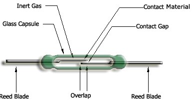

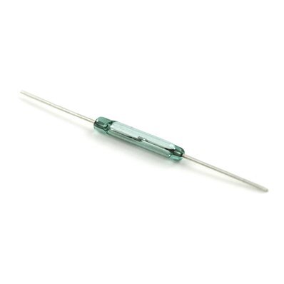

Method - II Using Reed Sensor image

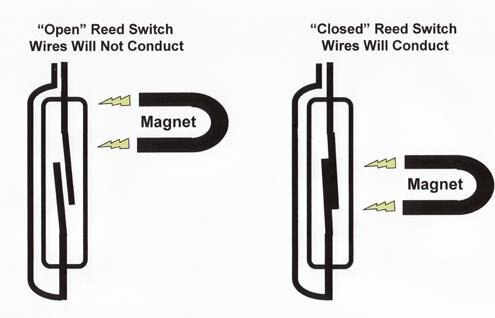

Next, My GENIUS mind came up with a magnetic solution as these sensor were cheep in market (about 5-10 INR / couple of cents) and Internet blames these to be Magnetic switches.
So I grabbed few from market, made a small board for them as they are pretty delicate and started testing. Here's How they Work:
Well It does act as a Switch but with a very poor response, It took couple of milliSec for the switch to detect the magnet thus making the entire fast detection thing pretty much useless and another Fail exercise for the job.

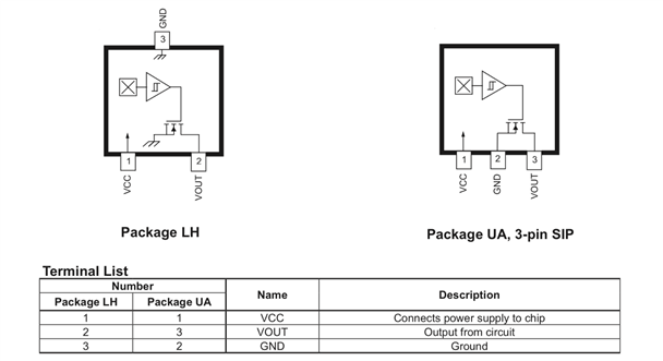

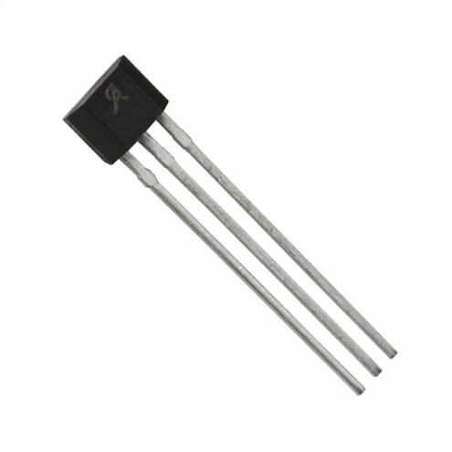

Method - III Using Hall effect Sensor (FINAL Method)
Well, we all love INTERNET and my Google Searching Skills payed off image When I came across This beautiful device called as Hall effect Sensor image image, My eyes sparkled while going through the data sheet and my gut said; This is it.
and so I went miles to fetch one of these babies (Well eBay did all the travelling credit to them image) and I received the beautiful sensor. I immediately ripped the package grabbed a Yun, breadboard and couple of wires. After few minutes of a basic Arduino Sketch I was able to achieve what I wanted. A fast magnetic way to get the job done.

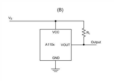

This is a Roucg Circuit Diagram
Click here for the Datasheet

Allegro A1104 Hall Sensor
10K Resistor
Bread Board
Couple of Single Strand Wire
Arduino development kit (Any Will Work I have tested using Yun)

imageA110x-Datasheet.pdf

    Hall Effect sensors are great.
    Be aware there are a variety of types. In your case it is triggered by the magnet like a momentary switch.
    There are others that latch, and others that will only respond to one pole.
    I think they are almost as useful as the 555 was to electronics all those years ago.
