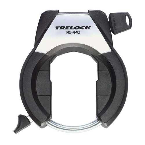

IDEA: When riding a bicycle, it is pretty hard to insure its security in the same way we do our cars. Bicycles are much lighter, and easier stolen, and often are not locked properly. This project aims to provide a solution to this problem. I want to provide a locking mechanism which will aid a U-Bolt lock in not only preventing a bike isn't stolen, but neither are the wheels. This along side an accelerometer to measure movement once the bicycle is locked in order to trip a security system. This security system and lock will be a part of the Internet of Things through an app which lets you remotely monitor your bike (as well as remember where you locked it up for those with the forgetful mind).
CONCEPT 1: THE LOCK
The first concept for this project is the lock which secures the tires to the frame of the bicycle preventing theft. The lock will look very similar to the following:
Related image
However, the lock I want to implement (and prototype) will be an electronic version of this which will be triggered to lock/unlock through the app that I am going to develop. Yet, we all know that the internet and wireless signals are not the most reliable things in the world, so I will have a manual override option in cases where it is needed (this solution: an old school key as seen in above).
