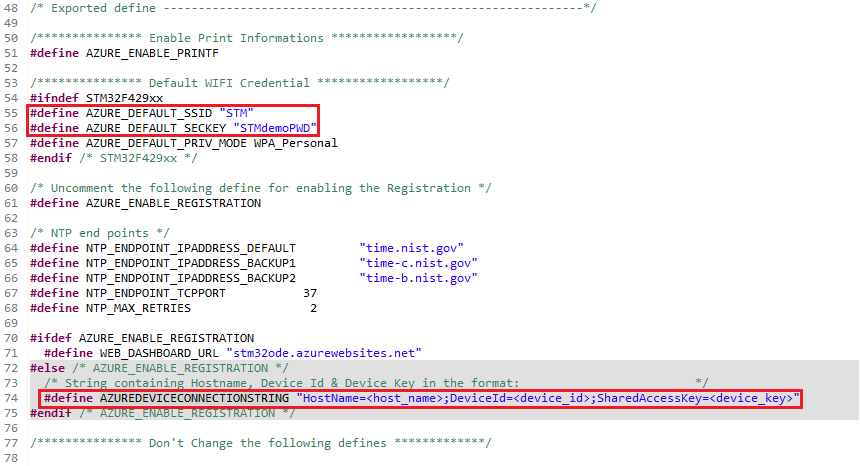

We will start by editing azure1_config.h which can be found in the "Includes" folder.
You will want to set up the WiFi connection here by editing the AZURE_DEFAULT_SSID and AZURE_DEFAULT_SECKEY to match your personal network. Then you will need to set up the AZUREDEVICECONNECTIONSTRING, which can be found in you IoTHub on your Azure Dashboard.
Once you have finished editing azure1_config.h, you can build all (found under the "Project" tab in the Workbench), and flash the binary to the Nucleo and you are ready to go!
