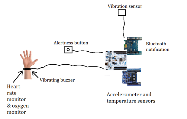

Here is my project:
Create a device that monitors your body to assess if you are too tired to drive. If you are already driving, it will alert you when you are too tired to drive. The device will
monitor your heart rate, oxygen level and breathing to assess your alertness as well it will also monitor your driving. If the device finds your alertness
isn’t what it should be it will notify you that you shouldn’t be driving. This will be done by alerting you through Bluetooth to the radio or vibration to
make you aware of your situation.
The development boards being used from STMicroelectronics:
STM32 Nucleo-L476RG Board
Sensor Expansion Board - X-NUCLEO-IKS01A2X-NUCLEO-IKS01A2X-NUCLEO-IKS01A2
Bluetooth LE Expansion Board - X-NUCLEO-IDB05A1X-NUCLEO-IDB05A1X-NUCLEO-IDB05A1
Below is a basic layout of my project:
Explanation of each:
  • Heart rate monitor and oxygen monitor
    • As you get tired your heart rate drops. This will alert the computer you are over tired. If your heart rate
      drops then suddenly spikes, this is more serious as it could be caused by nodding off for a second or two.
    • The oxygen monitor will tell the computer if your oxygen level is where it should be, being low on oxygen can
      cause drowsiness.
  • Vibrating buzzer
    • This will be one of the ways to alert you if you are falling asleep
  • Alertness button
    • If you are drowsy the computer will require you to check in by lighting an LED. When the LED is lit you must press
      the alertness button to confirm you are alert. This acts as another check by seeing how long it takes to react to the light, the longer it takes the drowsier
      you are.
  • Vibration sensor
    • This sensor will be located on the dash board. It will sense if the vehicle is drifting onto the side of the road.
  • Bluetooth notification
    • This will be another way for the computer to notify you of your situation.
  • Accelerometer and temperature sensor
    • The accelerometer will tell the computer of the speed you are traveling at. Any sudden changes will cause the computer to alert you.
    • Temperature sensor is used to record the internal vehicle temperature. Being too warm cause’s drowsiness, this would cause the computer to alert you of this as well.
There may be more added or changed, we have to wait and see how it goes!!
I hope everyone enjoys following along while I create my project.
Thank you,
Dale Winhold

    I was thinking about a similar project couple years ago as I was planning my road trip from Montreal to Florida by car. One factor you may want to consider is eye blinking as well Eye-tracking system monitors…

    Thank you for the feedback and ideas. I was also thinking about adding in an eye and face monitor (Which I still may do that) but I decided against it due to the complexity and the time we have to complete. I want to finish the proposed project first before adding anything to complex that may cause me not to complete. I do agree with you that eye tracking would be an important added sensor.
    One factor you may want to consider is eye blinking as well Eye-tracking system monitors driver fatigue, prevents sleeping at wheel | WIRED UK  . It is a more precise, but is much more complex design.
    Another interesting option is to monitor brain activity https://www.ncbi.nlm.nih.gov/pmc/articles/PMC3861841/ using EEG.
    Good luck!
