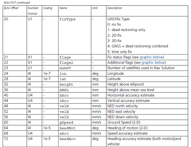

Navigation Position Velocity Time Solution
Until now I was using only two messages from UBX protocol NAV-POSLLH and NAV-STATUS in my project.
NAV-POSLLH is Description Geodetic Position Solution message and provides longitude and latitude information in a small 28-bytes payload, where NAV-STATUS is Receiver Navigation Status message, which describes how valid is information just by using 16 bytes of payload.
After some research I've decided to use NAV-PVT message. NAV-PVT is Navigation Position Velocity Time Solution message. It provides in one message the same information as NAV-POSLLH and NAV-STATUS, but in addition it gives  ground speed, heading, accuracy of readings among other interesting data. It comes with additional cost so. The message payload size is 92 bytes, which is significantly bigger then the other two messages.
I've changed my GPS receiver configuration code, by only enabling NAV-PVT message.
// Disable UBX
  0xB5,0x62,0x06,0x01,0x08,0x00,0x01,0x02,0x00,0x00,0x00,0x00,0x00,0x00,0x12,0xB9, //NAV-POSLLH off
  0xB5,0x62,0x06,0x01,08,0x00,0x01,0x03,0x00,0x00,0x00,0x00,0x00,0x00,0x13,0xC0, //NAV-STATUS off
  // Enable UBX
  0xB5,0x62,0x06,0x01,0x08,0x00,0x01,0x07,0x00,0x01,0x00,0x00,0x00,0x00,0x18,0xE1, //NAV-PVT on
As well I've added code to parse NAV-PVT message.
