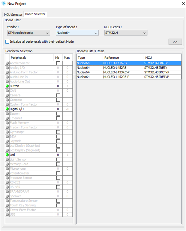

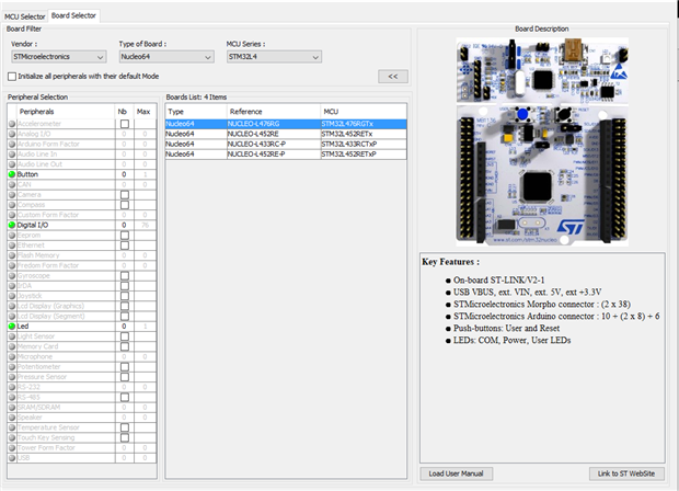

I've launched STM32CubeMx and selected STM32L476RG for a new project:

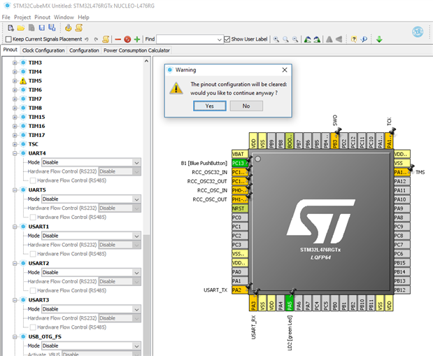

Then I observed my board parameters:
I've cleared all settings:

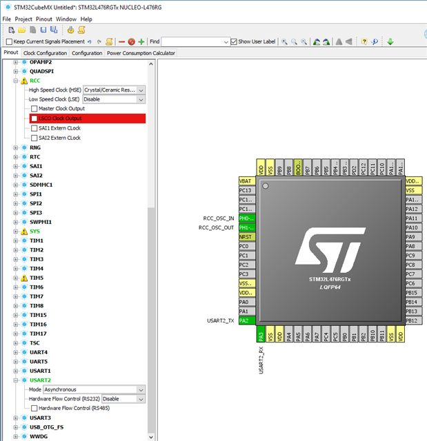

And I;ve set new parameters to configure RCC and USART2:

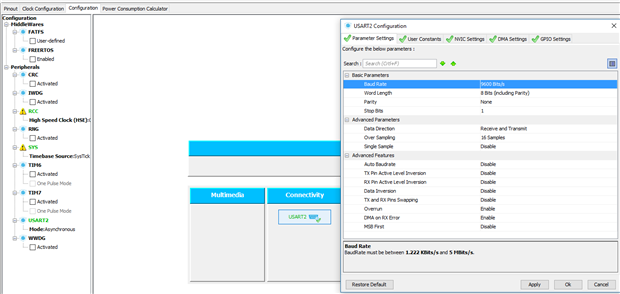

Then I've configured the serial port speed at 9600 BPS:

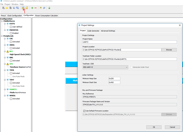

I've defined my project settings:

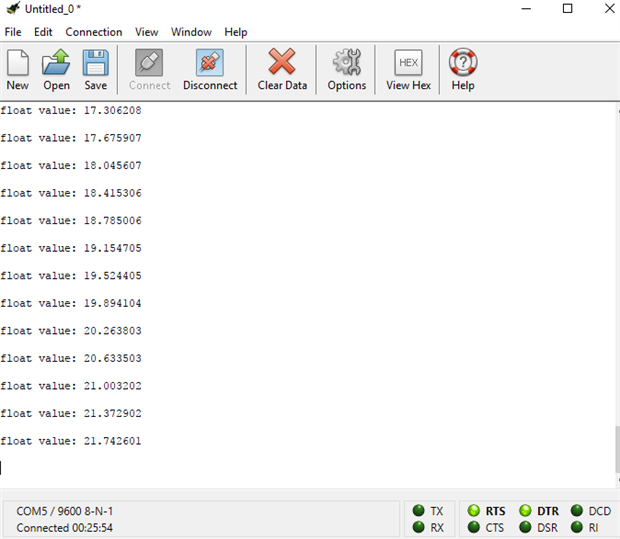

I've continued following the tutorial and was able to connect my STM32L476RG over serial to terminal:
