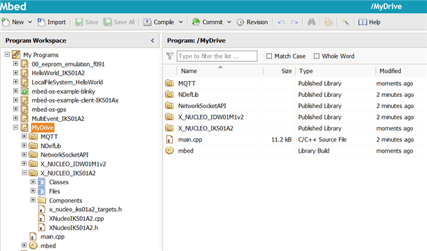

I've decided to get back to MBed platform as it provides a reach set of high level libraries. I've used IBM Watson IoT project as my base. I've removed NFC references. Then I've imported IKS01A2 library, replaced all references to Nucleo IKS01A1 with IKS01A2 as they are different boards.
I've tested that everything (STM32L476RG, WiFI, MEMS) still works after my modifications:

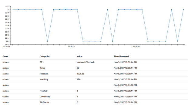

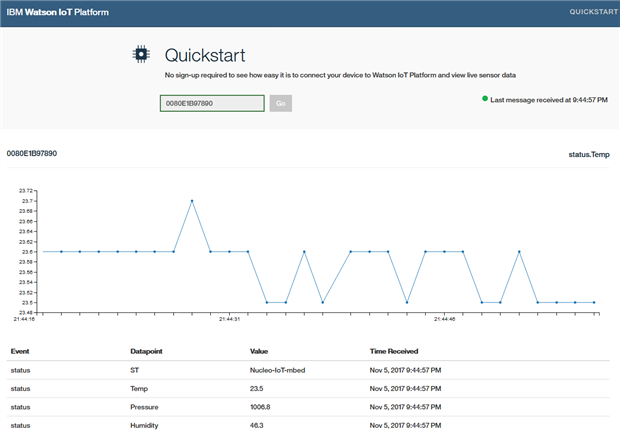

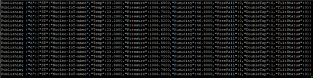

Again, I've tested that they get published in my terminal:
And as well get published to IBM IoT Watson:
