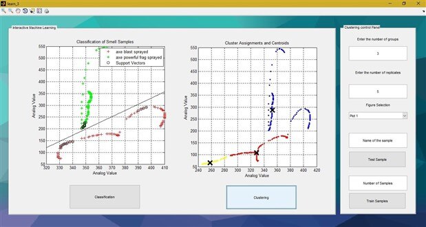

GUI for machine learning
     I have a GUI developed in MATLAB already for machine learning smells which can be seen below. The graph plotted to the left (Classification) separates the fragrance of one perfume from other (separated by a line).  The graph to the right (Clustering) clusters the smell values around the 'X' marked and thus separates them.
     Link to share your thoughts in Discussions related to the above project "Odor Detector", if interested - Is it possible to transmit and receive smell?

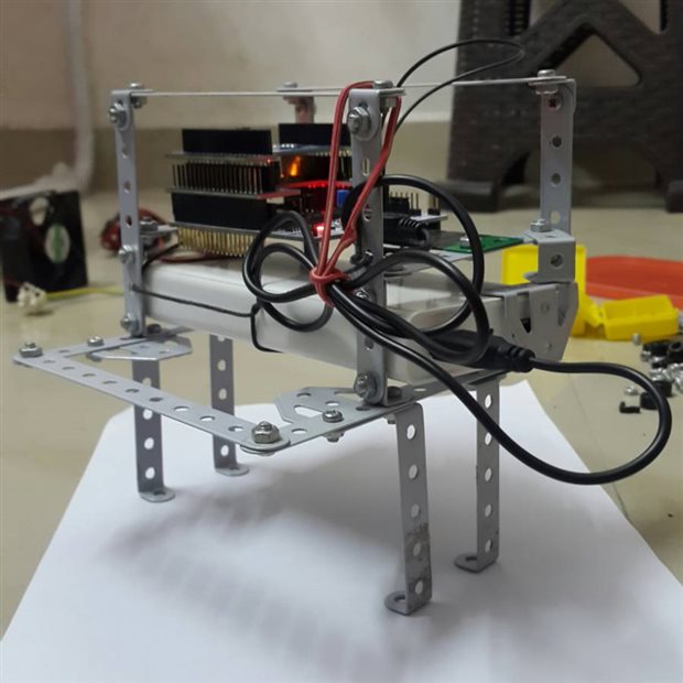

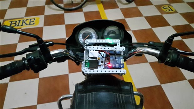

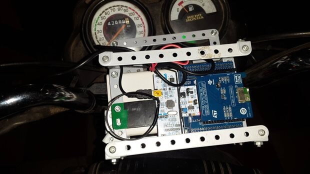

The case has been built to hold/mount the Nucleo-L476RG kit onto the vehicle therefore while on travel we can record the GPS location data in future modules to identify real-time traffic The case includes two provisions one to hold the MCU board with expansion boards and the other to hold the battery pack power bank Though the case is not an enclosure type it is hard enough to protect the case hold the kit and battery in position even in tough terrains and allows easier access I have added below photos video of the kit inside the case and mounted onto my bike
For those who are not able to afford 3D - Printers like me, I would suggest Metal Mechanix - 5. It has been much help in bringing my designs into life at a much faster rate.
{gallery} Case for the kit
Image 1: Case mounted in bike's handlebar
Image 2: The Case
Image 3: Case and the bike
Travel with the newly built case - Video
Please do not attempt to record audio / video while driving the vehicle alone or without any safety harness and auto recording equipments.

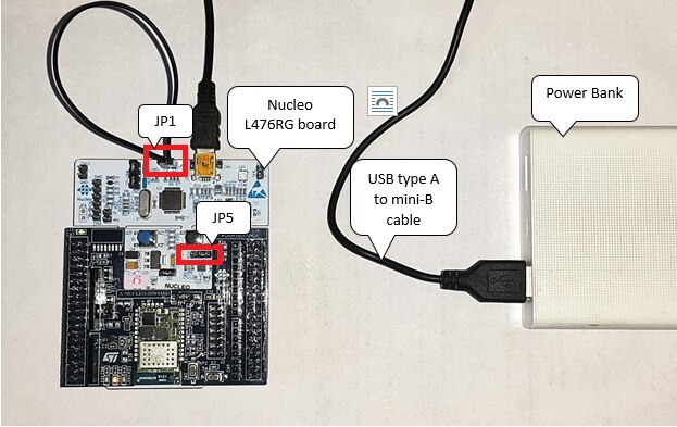

How to connect Nucleo-L476RG board to USB Charger Power Bank
Mobility would be the key criteria when it comes to moving the prototype to real-traffic to gather data for machine learning. So I have decided to use my 20,000mAh power bank with 5.1V 2A output as the external power source.
Steps to connect Nucleo-L476RG board to USB Charger Power Bank
  1. Connect the Nucleo-L476RG and the USB Charger Power bank using the USB type A to mini-B cable
  2. Make sure JP5's pin 1 and 2 are connected using a jumper (U5V).
  3. Turn ON JP1(using a jumper) to enable power supply from the USB Charger/ Power Bank.
Nucleo-L476RG board connected to power bank
Reference for this article: Nucleo-L476RG Datasheet

    Nice update. I do have one concern about your mounting bracket. I would add some shock mounting to the frame. Your current design will subject the electronics to vibrations, which could result in the cables…
  • dixonselvan
    dixonselvan over 9 years ago in reply to DAB +1
    Thanks, DAB I never thought that perspective of things. Will follow your suggestion
  • dixonselvan
    DAB over 9 years ago
    Nice update.
    I would add some shock mounting to the frame.  Your current design will subject the electronics to vibrations, which could result in the cables losing contact.
    Try adding some rubber washers and make sure you add external fasteners to the cabling to make sure they maintain contact at all times.
