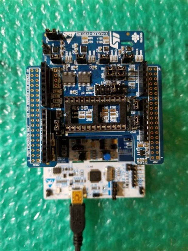

STM32 Setup:
  • The boards in the STM32 kit have been arranged as shown below.

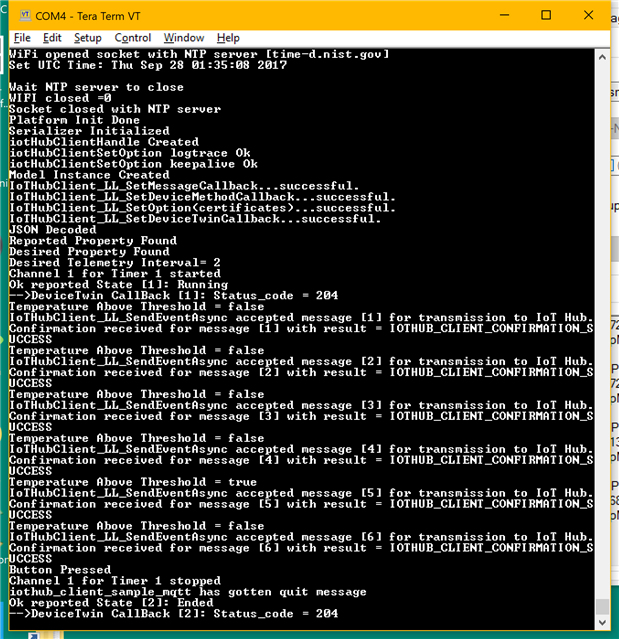

    3. Testing the Base Code Functionality:
      1. In SW4STM32 set the Wi-Fi credentials and Azure IoT Hub Connection String as described above. Also made some modifications for testing in AzureClient_mqtt_DM_TM.c file. These changes will be detailed in next blog once they are fixed.
      2. Then built the project from Project -> Build All menu option.
      3. Once the project is successfully built, deployed the code to STM32 base board by running CleanAzure1mbedTLS.bat in the directory C:\FP-CLD-AZURE1 3.0 RC1.0\Azure\Projects\STM32L476RG-Nucleo\Applications\Azure_Sns_DM\SW4STM32\STM32L476RG-Nucleo.
      4. Once the code is deployed to base board, it starts running automatically. So pressed the Blue Button on the base board to stop it running.
      5. Then started the Tera Term, set the port to work with and set the baud rate to 115200. Now the Tera Term is ready to receive from the base board.
      6. Now pressed the Black Button to reset the base board and once it starts running noticed the data is being sent to IoT Hub and getting the acknowledgement as shown in the screenshot below. You may notice the Temperature Threshold crossing also in the screenshot. But that logic is yet to be finalized.
Though all this was done a week ago, I couldn't blog it out due to work pressure and other engagements. In next blog I will show how I am capturing the Temperature alerts and also my plan for the mobile app.
