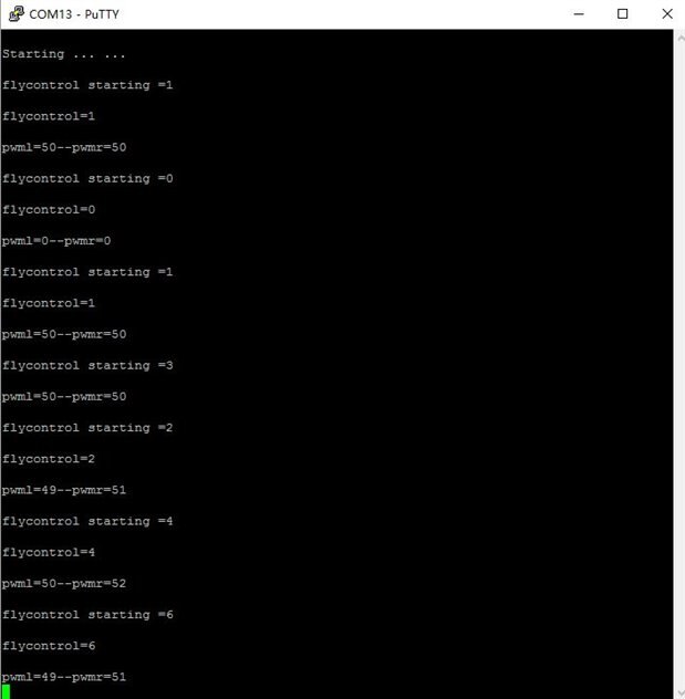

3. Here is screenshot for test result .
I used standard Serial communication in 9600bps. Code like printf() can be remarked in final version.
It work well with each number.

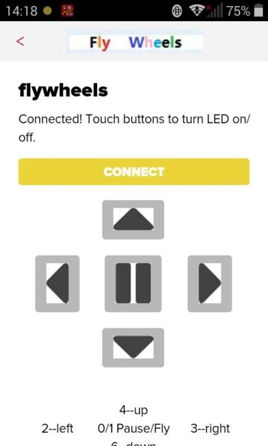

5. Another part is APP control, codes as attached zip files. I can not upload the barecode. So check it in whole. Also, android apk file build by cordova is the zip file too.
Screen shot as follows,
Optional, you can try text input directly. Same like button press.

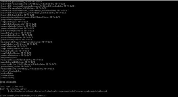

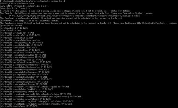

Here is the output for cordova build process
