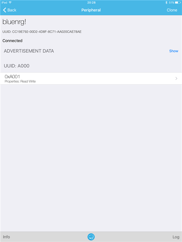

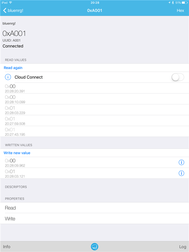

3. With Lightblue I can find the LED equiment and control from the console with 1 or 0 input to make the LED on or off
4. This is a simple test, therefore there is little to modify. The BLE service UUID is 0xA000 and BLE characteristic UUID is 0xA001. I can explore further with the design now.
