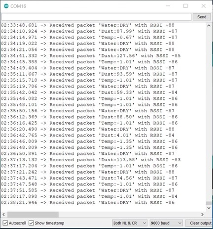

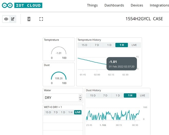

In the Freezer
  • I placed the case in our Freezer with the other frozen foods. The results are displayed in this section.
  • The inside case temperature was brought down below Zero Fahrenheit.
  • I'm not quit sure if I'm using the Dust sensor correctly, because there were some Hight Dust concentrations in the Case.
  • image   image  image  image

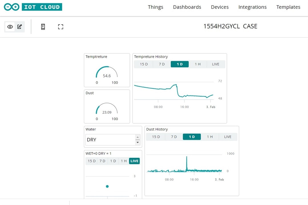

  • I placed the Enclosure in the Garage
  • It was in the garage for about 8 hours.
  • The temperature stayed around 52F degrees inside the enclosure. you can observe the dip in the temp chart on the dashboard below. It was a bit colder outside of the garage.
  • The results are displayed in the following section.
  • image   image   image
