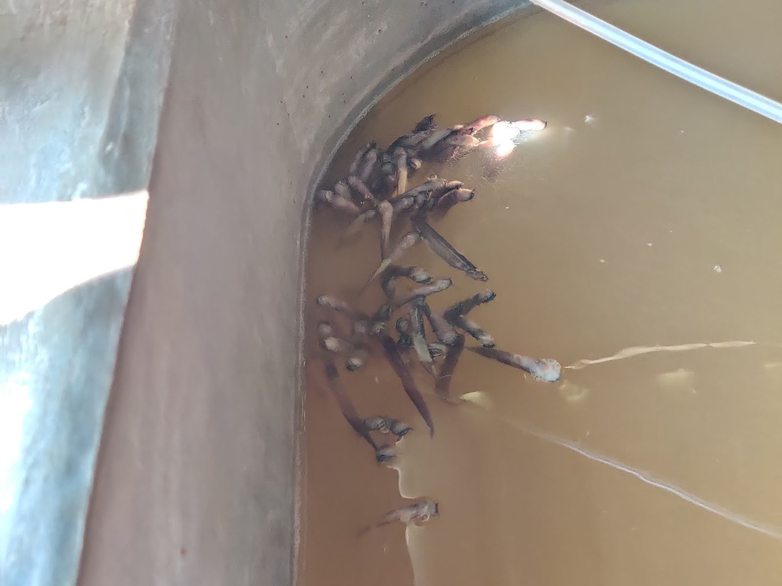

  • If the temperature increases during summer above the optimum mark, the DO (dissolved oxygen) level fall drastically, and the carbon dioxide levels increase. If you're cultivating fishes that respire using the dissolved oxygen, they'll come to the surface of the water and start gasping for air. If the DO level are not increased promptly, fishes will start dying and you'll end up with a huge number of dead fishes on your end.
    Carp babies gasping for air because of low levels of dissolved oxygen
