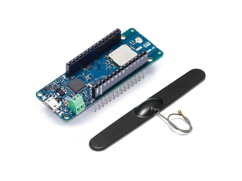

Hi, I'm Carlo Russo and I would like to talk today about the Arduino MKR1300 boards and the LoRa protocol.
The Just Encase kit is full of interesting components and I decided to start using the Arduino MKR1300.
I've been wanting to test LoRa connectivity for a long time now. As a network teacher, I find this technology very interesting, as it combines considerable distances covered with reduced power consumption.
This is the right opportunity to work with LoRa connectivity and I will start, step by step, to use the board starting from a simple initial configuration and gradually adding the sensors and the boards that will be needed to complete my project.
The first step is to study the connectivity between the two boards.
From the hardware point of view, I will only have to power the boards after connecting the antenna (not included in the Arduino MKR1300 package!).
The programming of the two boards was done using two example codes contained in the LoRa library, in particular the two codes are LoraSender.ino and LoRaReceiver.ino.
Here you will find the two codes.

It is impressive to see how with very few lines of code, the two boards begin to communicate with each other.
As always, Arduino devices are noteworthy for their extreme ease of use.
We will start from these two simple sketches to realize our project, modifying the code and adding more to adapt it to our needs.
