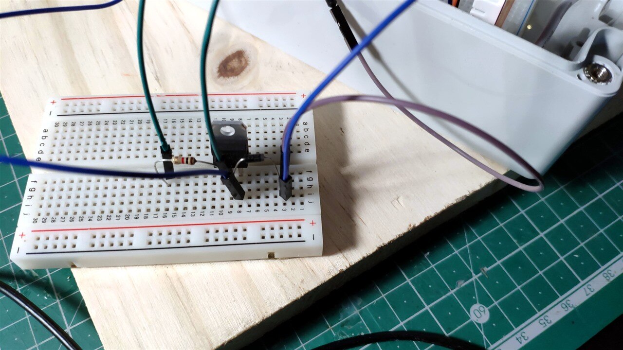

In my last post about the data collecting, I've spoken about the battery issues and wonder why it only lasts half a day.
I then wonder if using a MOSFET could solve the problem, by putting all the sensors in a subcircuit and activate it - letting the current on and off to the sensors by means of a MOSFET.
I did try it. Here are some photos of the testing:
But, because my electronic skills are limited and even with some google searches, I ended up losing the AM2302 sensor - not enough current for it, I guess. I did try with a TIP120 and a 1K resistor to the Arduino PIN, but no luck.
So, I've ended up with the same circuit I had before, already discussed here.
