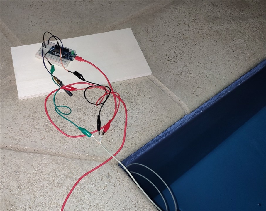

Note: Although in the picture, the Arduino is powered by USB (powerbank), the final try and the working prototype was being powered by two AA bateries.

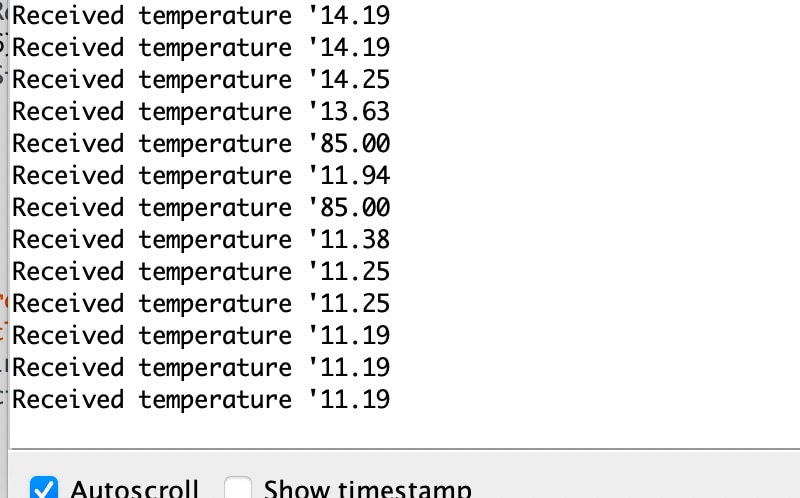

Here's both Arduinos connected to the computer, one sending the temperature and the other receiving it.
LoRa communication MKR 1300 WAN
Here's the Arduino MKR1300 WAN on the remote place
Arduino MKR 1300 WAN
And here's the result from the remote Arduino on the Arduino connected to the computer.
Remote temperature
