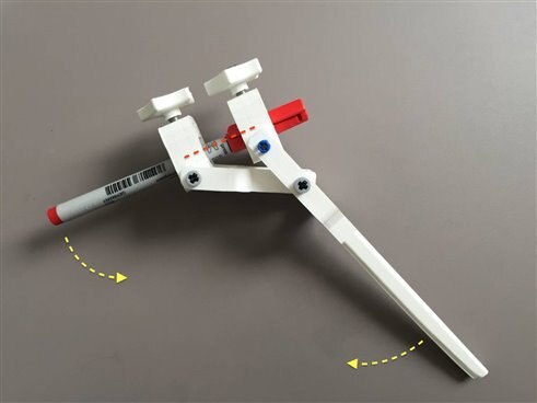

While waiting for the kit to arrive, I've started to think about the mechanical aspects of the challenge.
Simple acts are sometime difficult to model as they're so simple that we don't really think how we perform them.
The action of taking a cap off involve 3 forces (A, B & C), A & B are used to hold the 2 parts (sharpie & cap) and need to be performed at the same time while the third force (C) will take them apart and should be performed after A & B (while A & B are still on).
To understand and illustrate this a bit better, I've 3D printed a basic "tool" that can be usee to manually take cap off a sharpie.
Bolts are used to hold the sharpie and its cap, they simulate A & B.
Once the sharpie and its cap are hold by A & B, a simple lever is used to take them apart. This lever simulates C.
and ... it works!
That's the simple part of the challenge, now the real thing can starts...
PS: You'll notice that LEGO Technic pieces are very useful when 3D printing quick prototypes! image

    I've been thinking about your suggestion...  If I understand correctly, you are proposing to move the axle along the red dotted line as below, right?
    Also, I forgot to mention that in this 'manual prototype', the marker itself is used as a lever (see yellow dotted lines).

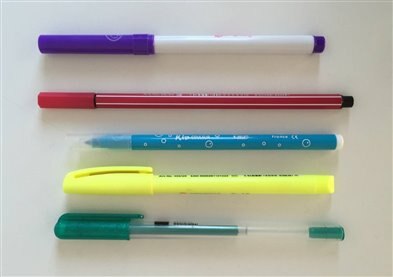

    I think I see what you mean... I've tried with the slot below but that only works with a certain types of caps and you also need to use markers of a common size.
    For example the above slot won't work with the red marker below where the cap and the marker are 'perfectly flush'.
    If I don't find a solution, I could limit the type of 'supported' markers but ideally, the apparatus should work with any type of (standard size) kids markers.

    dougw over 10 years ago in reply to e14 Contributor
    If the marker holder for the blue axis was moved down so the center of the marker is at the same height as the blue axis, the holder would only pivot to maintain pure axial loading in the C direction.
    Likewise, If the marker holder for the top black axis was moved down so the center of the marker is at the same height as the top black axis, the holder would only pivot to maintain pure axial loading in the C direction.
    I realize from these views that the black axles go right through, which would not be possible with the marker in the middle, but if you split the axle like the blue axle it could work.
    The way it is now you probably get some tendency for the holders to pivot, requiring more forces to stabilize, or at least you probably need to apply your force right at the holder to marker connection?
    This is probably not a clear explanation - let me know is a sketch is needed.
