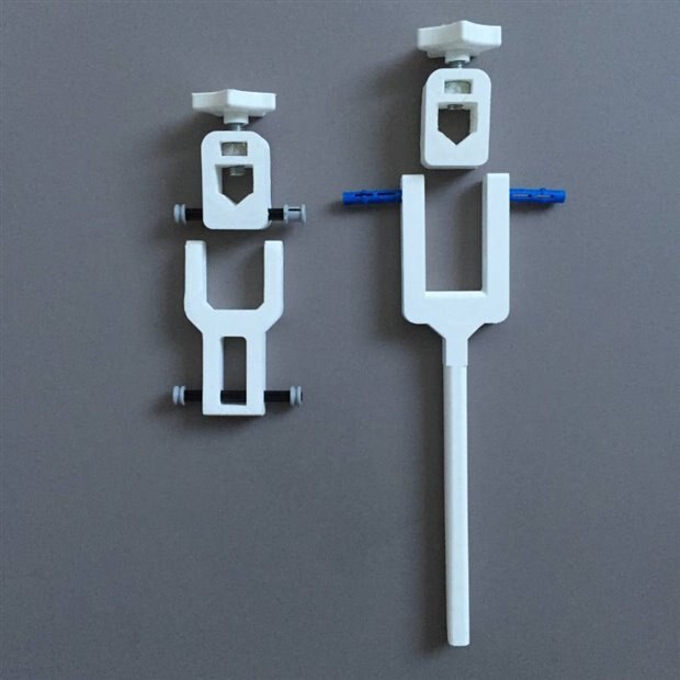

While waiting for the kit to arrive, I've started to think about the mechanical aspects of the challenge.
Simple acts are sometime difficult to model as they're so simple that we don't really think how we perform them.
The action of taking a cap off involve 3 forces (A, B & C), A & B are used to hold the 2 parts (sharpie & cap) and need to be performed at the same time while the third force (C) will take them apart and should be performed after A & B (while A & B are still on).
To understand and illustrate this a bit better, I've 3D printed a basic "tool" that can be usee to manually take cap off a sharpie.
Bolts are used to hold the sharpie and its cap, they simulate A & B.
Once the sharpie and its cap are hold by A & B, a simple lever is used to take them apart. This lever simulates C.
and ... it works!
That's the simple part of the challenge, now the real thing can starts...
PS: You'll notice that LEGO Technic pieces are very useful when 3D printing quick prototypes! image

    Just to make clear, this 'apparatus' is about helping taking caps off markers, it' not a drawing help or anything like that.
    People suffering from SMA have the physical ability to use pens and markers as it is very light, i.e. a few grams. The real problem is taking cap off, this action involves physical strength that they unfortunately don't have.
    e14 Contributor over 10 years ago in reply to dougw
    I am pretty sure this can be improved but I am not sure I understand your suggestion?! image
    Which pivots are talking about?
    Would this exploded parts picture help you to re-explain?

    cool mechanism - if the marker could be lowered to where the pivots aim through its centerline, would it work better?
