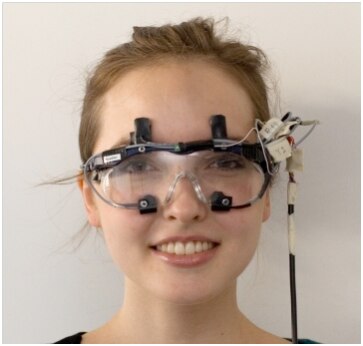

Eye tracker
There are many ways to implement the eye tracker.

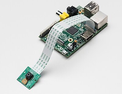

As the first option, I’d like to implement a camera-based eye tracker, based on the detection of eye movements by means of a camera
There are plenty of implementations of eye tracking algorithm. I will start from PyGaze, that will run on a Raspberry board.
They main advantages of this approach can be synthesize  as follow:
  • provides a very good measure of the eye movements. This is important since the drawing robot can also be controlled in speed (not only in position)
  • the technology is stable and tested, so the probability of success is greater than for the EOG-based approach
  • it allows to detect actions like eye blinking
However,
  • the resulting sensor is bulky, expensive  and power-hungry
  • the sensor requires a support to be mounted on

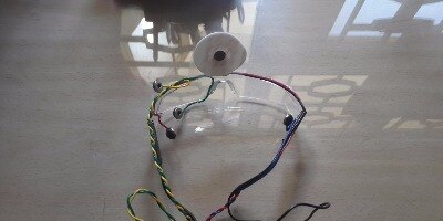

As a second option (depending on the amount of time available), I’d like to explore a EOG-based eyetracker. Straight out of Wikipedia,
Electrooculography (EOG/E.O.G.) is a technique for measuring the corneo-retinal standing potential that exists between the front and the back of the human eye. The resulting signal is called the electrooculogram. Primary applications are inophthalmological diagnosis and in recording eye movements. Unlike the electroretinogram, the EOG does not measure response to individual visual stimuli.
To measure eye movement, pairs of electrodes are typically placed either above and below the eye or to the left and right of the eye. If the eye moves from center position toward one of the two electrodes, this electrode "sees" the positive side of the retina and the opposite electrode "sees" the negative side of the retina. Consequently, a potential difference occurs between the electrodes. Assuming that the resting potential is constant, the recorded potential is a measure of the eye's position
Based on this concept, I will develop a glasses frame with integrated the electrodes to measure the corneo-retinal standard potential. The biosignal is amplified and analyzed to determine the position of the eyes.
The main advantage of this approach is that the resulting sensor
  • is small and easy to wear
  • is very cheap, since there is no need for big computational resources
However, is also presents several drawbacks
  • the sensor provides rough information about eye positions: it can just say if you are looking to the left, right, up or down
  • it uses biosignals, that are difficult to handle without a specific expertise in small analog signal processing (filtering and amplification)
The reason I'd like to explore this option is because an EOG sensor could be used in other projects as an wearable hand-free remote control. However since, as I told before, I don't have any expertise in this kind of technology, there are many threats that could bring the whole project to failure. This is why I'm going to keep a backup approach
