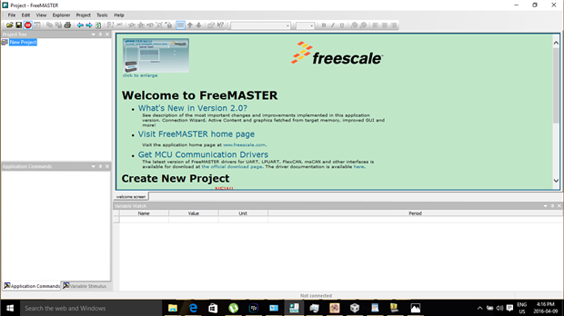

1. FreeMaster Run-Time Debugging Tool
I had no issues with the install. NXP states this is a user-friendly real-time debug monitor and data visualization tool

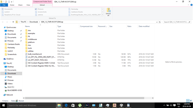

3. SDK_1.3 for KV31F120M
You have to build the platform before you download the Software Development Kit. I think this is the correct version I will need. You have to fill in some info on why you want to download this software.

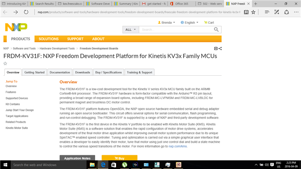

4. Kinetis Motor Suite
Kinetis Motor Suite enables the design of sensorless PMSM motor control applications. NXP states this will allow those with limited or no motor control experience to develop an application.image I had to define the path to the SDK.
