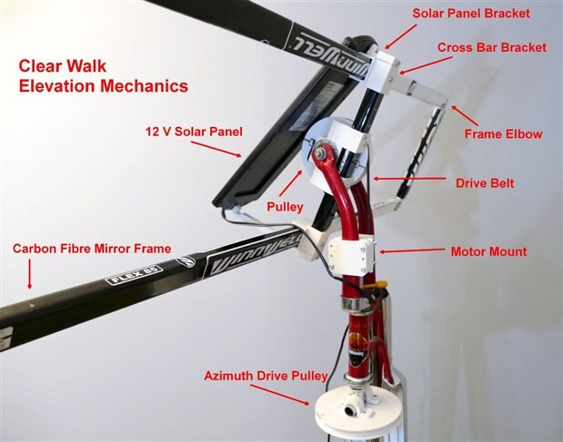

Another intense week - including 2 all-nighters trying to get the drive mechanisms designed, build and assembled. The image below has eighteen 3D printed parts, and there are more not shown.
Progress in this update:
  • I have mounted the solar panel which will keep the battery topped up.
  • Designed and built the mirror frame from carbon fibre (hockey sticks) and 3D printed elbows
  • Designed, built and assembled the solar panel brackets
  • Designed build and assembled brackets to hold the elevation drive arm to the elevation pulley
  • Designed built and assembled the cross bar brackets to mount the mirror frame
  • Designed built and assembled the gearmotor chassis
  • Designed built and assembled the motor mount bracket and clamp
  • Installed the elevation drive belt and tested motorized operation
  • Bought a bunch more parts including the big mirrors
A lot of effort went into design. It may not be apparent, but the entire system is very well balanced and the mirror plane is coaxial with the elevation pulley axle - requiring very little motor torque to hold or move the mirrors.
So far I have used almost a kilogram of plastic in my 3D printer - you don't realize the cost of printing a few parts until suddenly you have used a whole roll of filament.
The mechanism seems robust and stable although not quite as much travel as I had planned - making the brackets robust causes early interference.

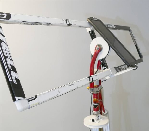

Here is the elevation motor in action driving the mirror frame:
Here is another angle of the mechanism: You can just see the motor between the forks:
Next I need to mount the azimuth drive motor and then hook up all the electronics and then get on with the software.

    DAB over 10 years ago +1
    Nice update Douglas. I agree, your configuration should give you good control in light winds. I am not sure it would survive strong winds, but that is a future test. It looks like you did a good job keeping…
    dougw over 10 years ago in reply to DAB
    Anchors would be stakes driven into the ground - like giant tent pegs.
    The system could also "park" itself in high winds to present minimal wind resistance. It cannot "freewheel" like a weather vane, but could go horizontal and put the narrow end towards the wind.
    It looks like you did a good job keeping the weight evenly distributed, though you might want to think about some anchor weights.
