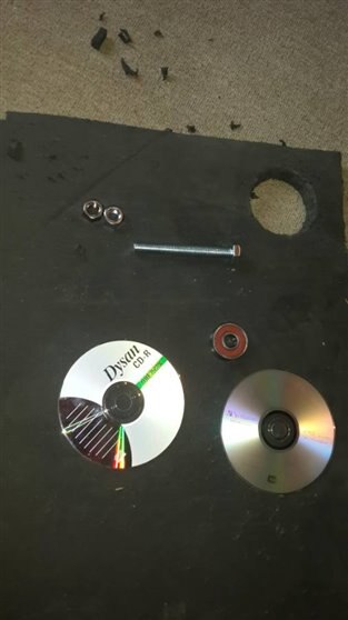

the components of a roller

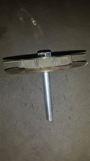

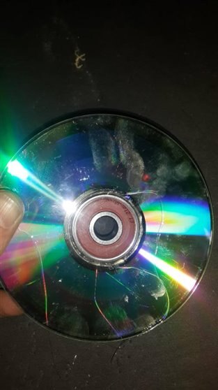

I cut the CD,s hole larger and glued the cd to the outside of the bearing

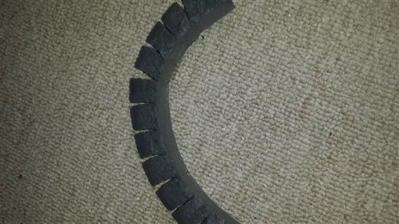

The Rubber was cut into strips and the strips cut at regulat intervals to aid in bending and chain gripping.
The rubber strip is rolled around the bearing and glued in place
A second CD is glued on the other side and a nut and bolt put through the bearing
