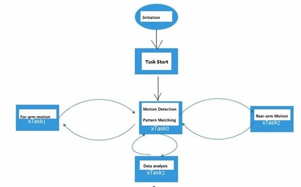

4.2 The revised Program Flow
4.2.1 My previous plan is running on FreeRTOS, which is fit for time-critical tasks and more concise in programming.
Of course, application of interruption can do same job but if I have enough resource, I still would like to use real-time OS control. Now, My Flow Chart is as follows,

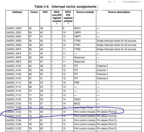

4.2.3 Enable & setup interrupts
The following code enable the interrupts
    /* Enable & setup interrupts */
    NVIC_EnableIRQ(PORTA_IRQn);                                                 /* Enable Interrupt */
    NVIC_SetPriority(PORTA_IRQn, 4);                                            /* Set priority to interrupt */
, The number of PORTA_IRQn is 59, according to reference manual, 59 is for PortA IRQ, which means falling edge on J1-3 or J1-12 can trigger this interrupt.

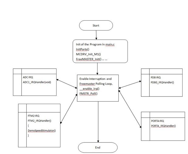

4.2.4 The IRQ handler PORTA_IRQHandler(void) shall put function void DemoSpeedStimulator(void)  into operation.
Therefore the definition of Port A-12 and Port A-13 can control the direction and degree of the motor.
ui32ButtonDirection is 1 for one direction and -1 for opposite direction. ui32ButtonDeltaSpeed is  constant 500 for now, this shall be changed with the movement speed of arm sensed by FDC2114 distance sensor.

4.2.5 The motor control is accomplished in  void DemoSpeedStimulator(void) with the following codes,
    if(bDemoMode)
    M1_SetSpeed(ui32ButtonDirection*FRAC16(1000.0/M1_N_MAX+ui32ButtonDeltaSpeed));
