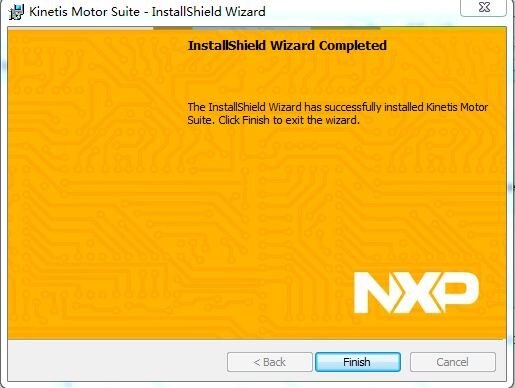

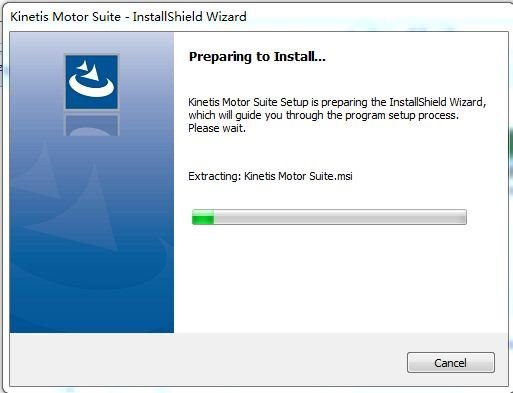

2. Install wizard appears after the installation file in .exe is launched.
                         Fig 5  Launch of Installation for KMS
                              Fig 6  KMS installation completed

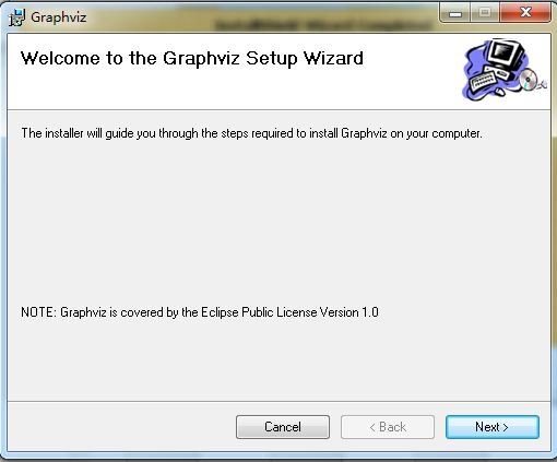

Graphviz is installed afterward, which is 3rd party GUI tool for generation of state diagrams for visual verification of motion sequences. This is plugin program and can not run independently.
                              Fig 7 Graphviz installation

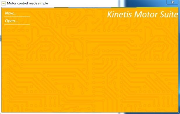

3.1 Launch KMS  as follows,
                              Fig 8  Launch KMS

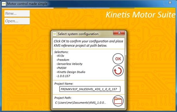

3.2 Selecting system configurationfor motor control step by step.
                              Fig 9 Selecting System Configuration

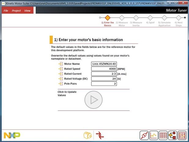

3.3 Creating Motor control and tuning with GUI interface.
The motor control needs acknowledgement on motors and controls for optimized operation. This software makes the whole process quick and reliable. The only choice left for us is to use it unhesitating regardless of the difficulty.
This KMS runs on the  basis of KSDK1.3 and KDS 3.2.0/IAR. The results can be tested right away.
                              Fig 10  Creating C codes
