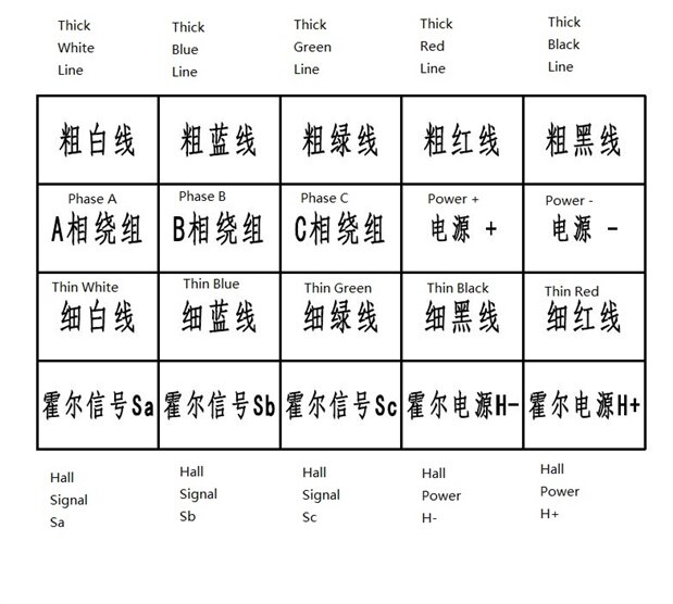

I have found a drawing for this Linix motor a attached. There are some Chinese words in the drawing. I try to translate it in English and shown in this screenshot.
image45ZWN24-DATA.pdf
    dougw over 10 years ago
    Thanks for translating...
