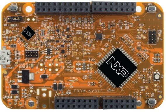

2 Introduction to  FRDM-KV31FFRDM-KV31F
The  FRDM-KV31FFRDM-KV31F is a low-cost development tool for the Kinetis V series KV3x MCU family built on the ARM Cortex-M4 processor,providing expansion board options of FRDM-MC-LVPMSM and FRDM-MC-LVBLDC for permanent magnet and brushless DC motor control Core component of the board are KV31F512VLL12 MCU(ARM CortexRegisteredM4 120 MHz 512 KB flash 96 KB SRAM and Six-axis sensor combining accelerometer and magnetometer(FXOS8700CQ
In fact controlling motor needs experience and knowledge on automation control theory While  FRDM-KV31FFRDM-KV31F platform minimizes all the prerequisite and allow designers focus on coding In this project Six-axis sensor combining accelerometer and magnetometer is very important for movement gesture catching Thus no more parts are needed for the development

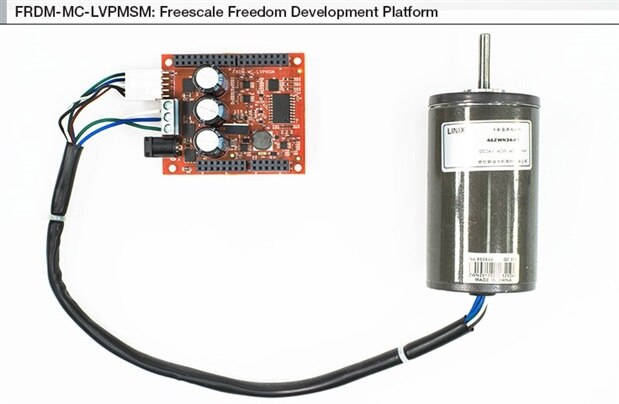

3. Introduction to FRDM-MC-LVPMSM
The FRDM-MC-LVPMSM low-voltage, 3-phase Permanent Magnet Synchronous Motor (PMSM) Freedom development board platform adds motor control capabilities, such as rotational or linear motion.
Key electrical parameters is as follows,
  • Power Supply Input voltage DC: 24-48VDC
  • Output current up to 5 amps RMS
  • Power supply reverse polarity protection circuitry
  • 3-phase bridge inverter (6-MOSFET’s)
  • 3-phase MOSFET gate driver with over current and under voltage protection
FRDM-MC-LVPMSM can plug into the corresponding socket in  FRDM-KV31FFRDM-KV31F And same for other motor drive development board like tower series and HIGH Voltage development This motor is rated at least 120W It is so powerful that it can drive a e-bike In this case the motor kits is a practical choice and not for demo only
While the only remain problem is the rotary speed is too fast for human movement. For PMSM motor, the rotary ratio is at least 3000rpm. According to my experience, the torque applied by the motor shall exceed 30kg.cm. Detail documentary shall be look through upon receiving the DEVELOPMENT PACK.
