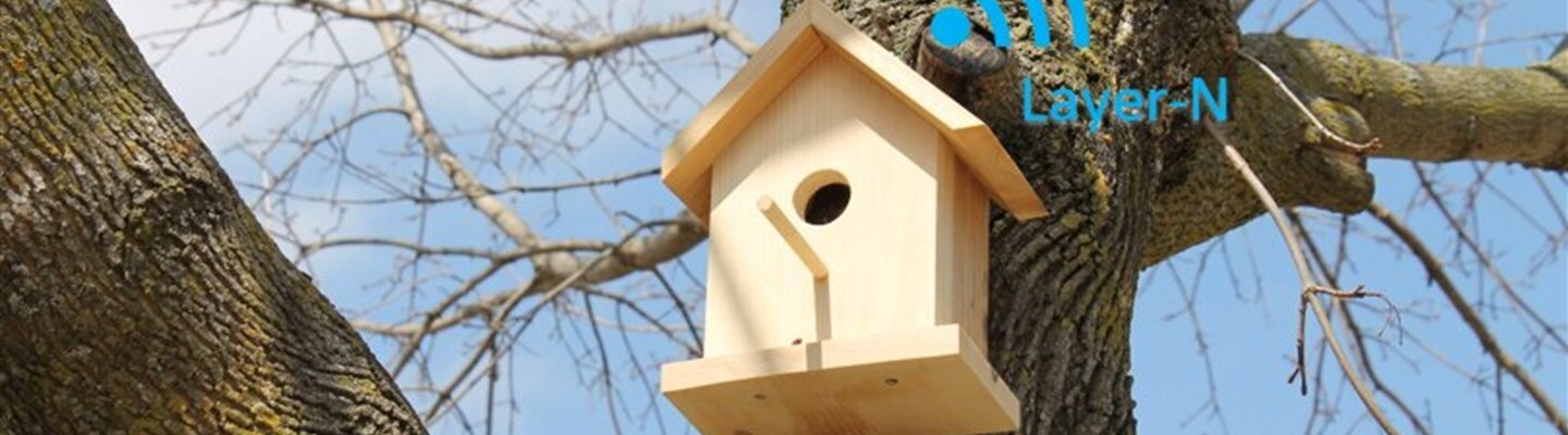

The ability to “Tap” a tree and have tree sap flow at a rate similar to that of leaky faucet dripping every second or so, is a strong function of the temperatures a Maple tree experiences in late winter and early spring. One of experiments I conducted with the layer-n ecosystem was to monitor the a Maple trees temperature during a freeze thaw cycle. I constructed a custom sensor enclosure fitted with the SS-002-01 wireless sensor node.
I mounted a k-type thermocouple a few millimeters below the tree’s bark.
I managed to capture one of the last days where sap was actively flowing out a tap. You will notice a fain sap stain on the enclosure and fly’s enjoying an early spring lunch from the small amounts of sugar in the sap.
I managed to collect at least one freeze/thaw cycle with the layer-n ecosystem. Here is the recorded data available on the omega cloud platform:
In this limited time window, the sub-bark tree temperature tracked the ambient air temperature very closely. So, to keep record of the number and span of freeze/thaw temperature excursions in late winter, maybe just the wireless smart sensor is all that is needed. This can then be correlated to the sap yield daily or seasonally.
Is a birdhouse the ultimate sensor enclosure? Possibly, though I would recommend omitting the entrance hole for birds. Although no birds actually made this house a home, they did stop by a take a look at the wireless sensor node:)

    Pity the bird.
  • scottiebabe
    scottiebabe over 4 years ago in reply to maxpowerr
    lol the birdie may have left a 1-star review for the IOT hotel, but give the nearby all day free buffet bird feeder a 5-Star review Bird
