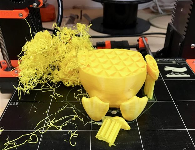

In 3D printing operations at print-farm scale, maintaining filament material quality is crucial for production continuity. High ambient humidity triggers filament degradation, making it brittle and significantly increasing the risk of stringing, poor layer adhesion, printhead fragility, and nozzle clogging on high-speed printers such as the Bambu Lab P1S, A1, and A1 Mini.
These physical issues lead to high print failure rates and costly downtime. The absence of an integrated monitoring system makes it difficult for operators to detect print failures early, often resulting in entire production batches being wasted before the problem is noticed.

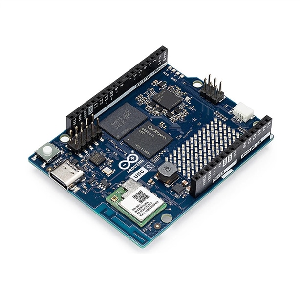

2.1 Main Platform: Arduino Uno Q
The Arduino Uno Q was selected as the main platform because it integrates two processors on a single board, enabling the system to operate simultaneously as a single-board computer and an Arduino microcontroller:

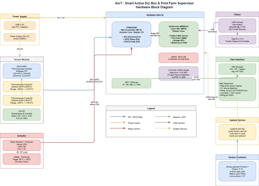

Hardware Block Diagram
The hardware block diagram illustrates the physical connections between all system components.
3.1 Component Block Descriptions
Block
Description
Power Supply
Two power sources: USB-C 5V for the Arduino Uno Q (distributed internally as 3.3V and 5V for sensors and relay), and an optional 24V DC external supply originally planned for the HX94C industrial sensor.
Arduino Uno Q
System core. The STM32U585 handles all hardware I/O via SPI (thermocouples) and GPIO (relay, DHT22). The Qualcomm QRB2210 runs Python, the WebUI, and AI inference. Both chips communicate through Bridge RPC over /dev/ttyGS0.
Sensor Module
Two MAX31855 modules share the SPI bus (CLK=D13, DO=D12) with separate chip selects (CS1=D10 and CS2=D9) for two K-type thermocouples. DHT22 is connected to D2 with a 10 kOhm pull-up resistor to 3.3V.
Actuator
A single 1-channel relay that switches the dry box heater. Control signal comes from D6 on the STM32, using active LOW logic so the heater defaults to OFF at power-on for safety.
Vision
A USB camera connected to the Qualcomm QRB2210 USB port. OpenCV 4.13 captures 640x480 frames, which are then processed by the YOLOv8n ONNX model for print failure detection.
User Interface
A Python WebUI dashboard accessible from any browser on the local network at port 7000. Displays real-time sensor data, live annotated video, failure logs, and a relay control panel.
System Service
A systemd service (smart-drybox.service) ensures the entire system starts automatically on board power-on. An inotify watcher script monitors app-compose.yaml to persistently maintain port 7000 mapping across container restarts.
3.2 Inter-Block Connections
From
To
Protocol
Notes
Thermocouple x2
MAX31855 x2
Analog (mV)
Thermoelectric signal converted to digital by MAX31855 amplifier
MAX31855 x2
STM32U585
Software SPI
Shared CLK+DO bus, separate CS pins D10 and D9
DHT22
STM32U585
1-Wire GPIO D2
Temperature and humidity readings every 2 seconds
STM32U585
Qualcomm QRB2210
Bridge RPC
update_data() sensor payload and set_relay() commands via /dev/ttyGS0
Qualcomm QRB2210
STM32U585
Bridge RPC
Relay control command: Bridge.call("set_relay", state)
USB Camera
Qualcomm QRB2210
USB / V4L2
640x480 video frames for AI inference pipeline
Qualcomm QRB2210
Web Browser
HTTP REST port 7000
JSON sensor data, JPEG frame in base64, log events
STM32U585
Relay Heater
GPIO D6 Active LOW
On/off control of the dry box heating element

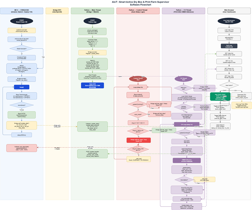

4. Software Flowchart
The software architecture runs across 4 parallel threads that communicate through shared state objects protected by threading.Lock(). An interactive flowchart is available as a draw.io file: smart_drybox_software_flowchart.drawio.
4.1 Thread Architecture Overview
Thread / Lane
Interval
Responsibility
MCU (STM32)
2 seconds
Read sensors (TC1, TC2, DHT22), send data via Bridge.call(), receive relay commands
Python Main
Event-driven
System initialization, Bridge.provide() registration, REST API exposure, WebUI blocking serve
Control Thread
3 seconds
Automatic relay control logic based on sensor data and setpoints, warning log recording
CV Thread
1 second
Load ONNX model, open camera, run YOLOv8n inference, annotate frame, update latest_cv state
Web Browser
Poll 1-2s
Fetch JSON from REST API, render dashboard, send POST /system commands from user interaction

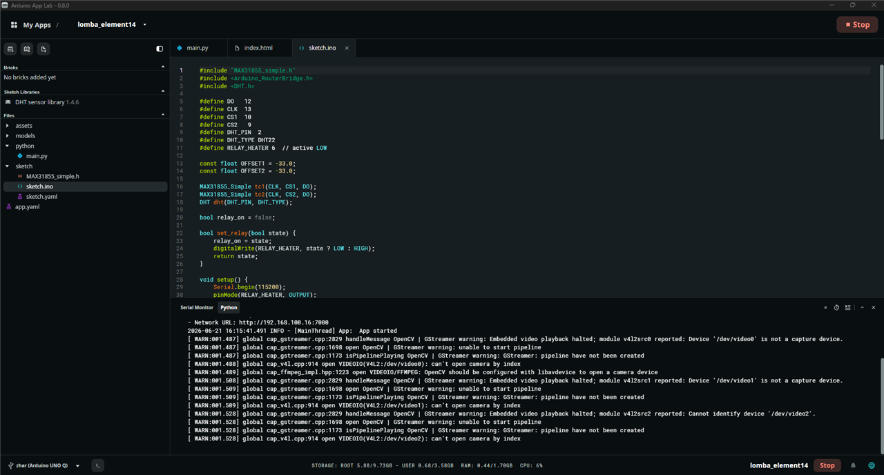

4.2 MCU Flow (STM32U585 — Arduino Sketch)
After the board powers on, the systemd service runs arduino-app-cli which compiles and flashes the sketch to the STM32 if changes are detected. After setup() completes initializing all peripherals, loop() executes every 2 seconds:
  • Read both thermocouples through the MAX31855 modules via Software SPI, applying calibration offsets
  • Check for error conditions (isnan) from thermocouple readings
  • Read DHT22 for ambient temperature and humidity
  • Send all data to Python via Bridge.call("update_data", ...)
  • Receive relay control commands from Python via the registered callback Bridge.provide("set_relay", ...)

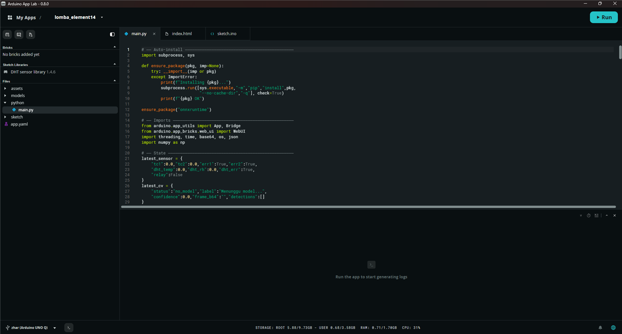

4.3 Python Main Thread Flow
The Python app runs inside a Docker container managed by arduino-app-cli. Initialization sequence:
  • ensure_package(): auto-install onnxruntime into the venv if not already present
  • Initialize shared state objects: latest_sensor{}, latest_cv{}, system{}, logs[]
  • provide("update_data"): register callback to receive sensor data from the MCU
  • WebUI().expose_api(): register GET /data, /cv, /frame, /logs endpoints and POST /system handler
  • Thread(): spawn the Control Thread and CV Thread as daemon threads
  • run(): blocking call that serves HTTP requests on port 7000
4.4 Control Thread Flow
This thread is responsible for automatic relay control logic and runs every 3 seconds:
  • If system["printing"] is False: force relay OFF unconditionally
  • If system["auto_mode"] is False (Manual mode): send Bridge.call("set_relay", manual_relay) per user input
  • If Auto mode is active: compute average temperature from both thermocouples, turn heater ON if below temp_min (default 50 degrees C), turn OFF if above temp_max (default 60 degrees C)
  • Detect abnormal conditions: temperature exceeding temp_max or humidity below rh_min, and record to log via _add_log()
4.5 CV Thread Flow (YOLOv8n Inference)
The computer vision thread runs every 1 second and executes the following pipeline:
  • Wait for best.onnx model file at /app/models/, update status to "no_model" while waiting
  • Load ONNX model using onnxruntime with CPUExecutionProvider
  • Open USB camera (scan /dev/video0, 1, 2), fall back to a dummy black frame if no camera found
  • If system["printing"] is False: render frame with "SYSTEM INACTIVE" overlay, skip inference
  • Preprocessing: resize to 320x320, convert BGR to RGB, normalize by dividing by 255, transpose to CHW format, add batch dimension
  • Inference: session.run() produces output tensor of shape [1, 10, 2100]
  • Postprocessing: filter detections by confidence > 0.6, decode bounding boxes, map class indices to 6 class names
  • Annotation: draw color-coded bounding boxes per class, add confidence labels, status bar overlay, and timestamp
  • Encode annotated frame to JPEG base64, update latest_cv{} for browser delivery
  • If any detections found: append failure log entry via _add_log()
4.6 Web Browser Flow (User Dashboard)
The web dashboard uses a 3-column layout and performs asynchronous polling:
  • GET /data every 2 seconds: update thermocouple cards, temperature, humidity, and relay status
  • GET /cv every 1 second: update detection status badge and detected class chips
  • GET /frame every 1 second: update camera image with bounding box annotations
  • GET /logs every 10 seconds: render failure and warning log table
  • POST /system: send user commands (START/STOP PRINT, AUTO/MANUAL mode, setpoint changes, manual relay toggle)
  • Auto-log timer: after START PRINT, automatically append a log entry every 60 seconds with countdown timer
  • CSV download: export the full log history to smart_drybox_log.csv in the browser

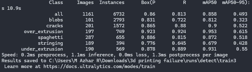

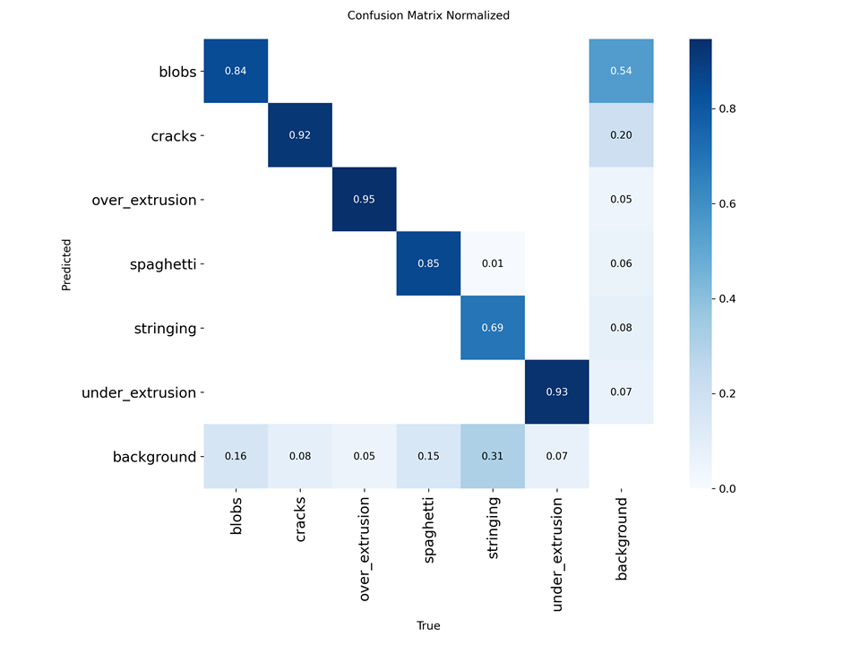

5. AI Model — YOLOv8n 3D Print Failure Detection

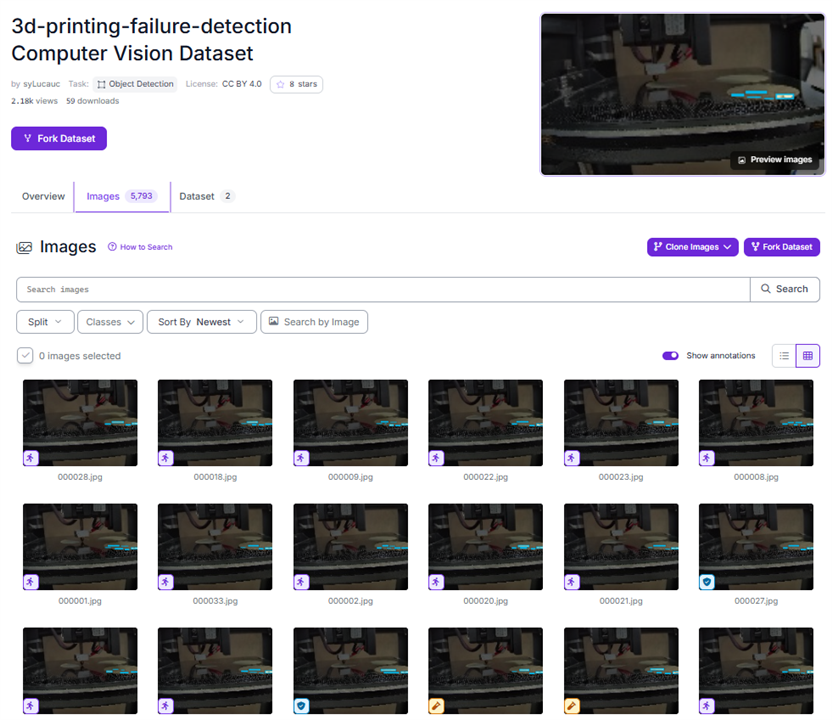

5.1 Dataset
Parameter
Value
Dataset Source
Roboflow Universe: 3d-printing-failure-detection v3 (CC BY 4.0)
Total Images
1,161 images (train + val + test split)
Total Instances
6,732 bounding box annotations
Number of Classes
6 print failure classes
Label Format
YOLOv8 (.txt per image)
5.2 Detection Classes and Per-Class Performance
Class
Images
Instances
Precision
mAP50
mAP50-95
blobs
101
2793
0.831
0.812
0.323
cracks
201
1572
0.865
0.900
0.522
over_extrusion
197
749
0.923
0.953
0.615
spaghetti
287
655
0.886
0.872
0.518
stringing
189
394
0.776
0.679
0.428
under_extrusion
190
569
0.878
0.931
0.550
ALL (overall)
1161
6732
0.860
0.858
0.493
5.3 Model Specifications
Parameter
Value
Architecture
YOLOv8n (nano) — 3,006,818 parameters, 8.1 GFLOPs
Export Format
ONNX opset 19, simplified with onnxslim 0.1.82
Input Shape
[1, 3, 320, 320] BCHW
Output Shape
[1, 10, 2100] — 10 = 4 bbox coordinates + 6 class scores
File Size
11.6 MB — very lightweight for edge deployment
Inference Engine
onnxruntime 1.27.0, CPUExecutionProvider
Confidence Threshold
0.6 (to minimize false positives on non-printer scenes)
Reported Speed
0.2 ms preprocess, 1.1 ms inference, 1.3 ms postprocess per image (training machine CPU)
6. Web Dashboard
6.1 Dashboard Features
The dashboard is accessible from any browser on the local network without installing any additional application, at http://[Board-IP]:7000. Available features:
Feature
Description
3-Column Layout
Sensor panel (left), Camera + Log (center), Control panel (right)
Bilingual ID / EN
Language toggle button in the top-right corner; all UI text switches dynamically between Indonesian and English
Real-time Sensor Cards
Updated every 2 seconds: TC1, TC2, DHT22 temperature, DHT22 humidity, relay status indicator
Live CV Feed
Camera frame with bounding box annotations updated every 1 second, with detection status badge
START / STOP PRINT
Activates or deactivates the full automated system: relay auto-control and CV inference pipeline
AUTO / MANUAL Mode
AUTO: relay controlled by the system based on sensor readings; MANUAL: operator controls relay directly via toggle
Adjustable Setpoints
Target temperature range (min/max in degrees C) and minimum humidity threshold can be changed live from the dashboard
Log Table
Tabular log of failure detections, system warnings, and auto-log entries with color-coded event types (red/amber/purple)
Auto-Log Timer
After START PRINT, a log entry is automatically appended every 60 seconds with a visible countdown timer
Download CSV
Export the full log history to a timestamped CSV file directly from the browser
Visual Alerts
Sensor cards turn amber when readings are outside setpoints; CV badge blinks red when a failure is detected
6.2 REST API Endpoints
Method
Endpoint
Response
GET
/data
JSON: tc1, tc2, err1, err2, dht_temp, dht_rh, dht_err, relay
GET
/cv
JSON: status, label, confidence, detections[] (frame_b64 excluded)
GET
/frame
JSON: frame_b64 — annotated JPEG frame encoded as base64 string
GET
/logs
JSON array: up to 100 most recent log entries (time, tc1, tc2, dht_temp, dht_rh, relay, event)
GET
/system
JSON: current system state (printing, auto_mode, setpoints, etc.)
POST
/system
Request body JSON: printing, auto_mode, manual_relay, temp_min, temp_max, rh_min
7. Original Concept vs. Actual Implementation
Aspect
Original Concept
Platform
Arduino Uno Q + CAN Bus MAX33041
Arduino Uno Q, Bridge RPC via /dev/ttyGS0
Humidity Sensor
OMEGA HX94C (4-20 mA, 24V DC)
DHT22 (digital 1-Wire, 3.3V) — replaced due to ADC voltage incompatibility and zero readings
AI Model
TensorFlow Lite / YOLO Nano
YOLOv8n ONNX, onnxruntime 1.27, mAP50 = 0.858
Visualization
NI LabVIEW HMI
Python WebUI, HTML/JS, REST API — accessible from any browser without software installation
ML Backend
Decision Tree on external server
Edge inference directly on board — no server dependency
Communication
CAN Bus to server infrastructure
Bridge RPC (MCU to Linux) + WiFi (board to browser)
Deployment
Not specified
systemd + Docker, fully automatic on board boot
Heater Control
Relay via CAN Bus
GPIO D6 STM32, active LOW, PID-like logic via Python control thread at 3-second intervals
